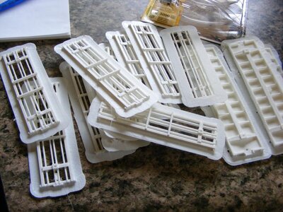

this may save you some time, maybe not .. anyways i do have a truss rod flatcar on thingiverse ...
it can be built from basswood strips, 3d printed with a fdm printer, or cnc'd out of one piece of wood..
i have used all of these ways in the past ... you still need the archbar trucks and detail parts also

Those look great! I have been thinking about getting a 3D printer for a long time, this may just push me over the edge. I have a lot more flat cars I want to build, and the underframes are always the most time-consuming part of it.
