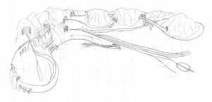

Kevin, For some reason I cannot send a private message with an image so I thought I would add this onto your thread here.
Here is a picture of where I've been heading. I actually had this drawn up and for some reason the software decided to eat it, so I am having to start over again. I hate "CAD-like" software. Obviously the perspective is wrong, but after many sketches this is the first one that sort of captured my vision of what we talked about. Let me know if it seems like what you also had in mind. Just staring at it the last couple days I got an idea how to solve one of the logistical problems I've been having. By the way, this is into the minimum 13" radius range. Going up to 15" really limits the possibilities for interlacing the tracks through tunnels.

Well, this is embarassing. I forgot to come and update this thread. My layout area got confiscated by my wife's daycare. I actually gained control of a much larger room though so it worked out for the better. But yes IH, you pretty much nailed what I have in mind. I am leaning more toward a prototype though now (which may be of some help?). I have spent the past couple weeks talking with a couple guys who convinced me, if I want to run the Big Boy I really should model the appropriate railroad. Which is the Wyoming Division of the Union Pacific Railway. So I am researching that line.

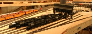

That is good advise and greatly narrows the scope for both the track plan and for future rolling stock purchases. So now that turntable will be the "anchor" city. I think there is a similar model of the Cheyenne coal tower in N-scale. I think it is a must to go with the turntable.
