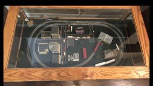

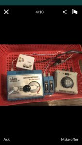

I found a complete set used I will include pics is, I'm sure it's worth more than the 125 she is asking but it defeats the purpose of designing and building our own.
Any opinions or comments appreciated.
Fully enclosed Table size is 48 x 28

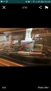

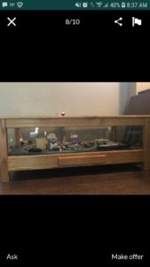

More pics, this also includes the table as well

While this layout makes a nice conversation piece, I would not recommend it for a layout with your grandson, as it is too complete, unless you and he just want to watch a single train run round and around. That will bore both of you pretty quickly.
