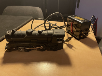

I think I have the same engine. This was my father's model train when he was a kid in Los Angeles and probably dates to mid 1940's. I have the original power supply but want to get a new one that won't cause a fire and is 220v. The old power supply is 60 cycle, 110/120v, and 13v out to track. Can you tell me what power supply you are using and where did you get it? I am also in NL. Thanks.
