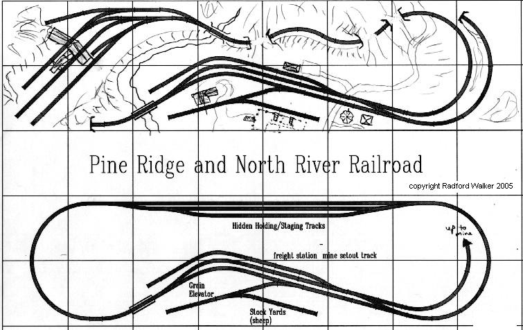

Of course, I always recommend a out and back type layout, as below. It has only 1 yard / station where the train originates. It does out and runs on the mainline for a certain amount of time and then returns to that same yard / station as a destination pretending it is a different place. Imagine stretching this out into a space twice as long.

If it isn't obvious the first is a standard 4' x 8' and about the smallest one can get away with a out-and-back type design. The second is an Atlas plan that is 4' x 12' and is what inspired my design of the first one.

Considering that, makes me think of a "staging yard". Consider this design. It is n-scale on a 2'x8', basically a simple loop with a branch to a mine, but it houses multiple trains between the backdrop and mountains. So one can just have lots of parked trains and just hook the loco to the one you want to run at the moment. They don't distract from the illusion of a train running through scenery as they are hidden under the mountain. With 4'x16' space that could work well.
