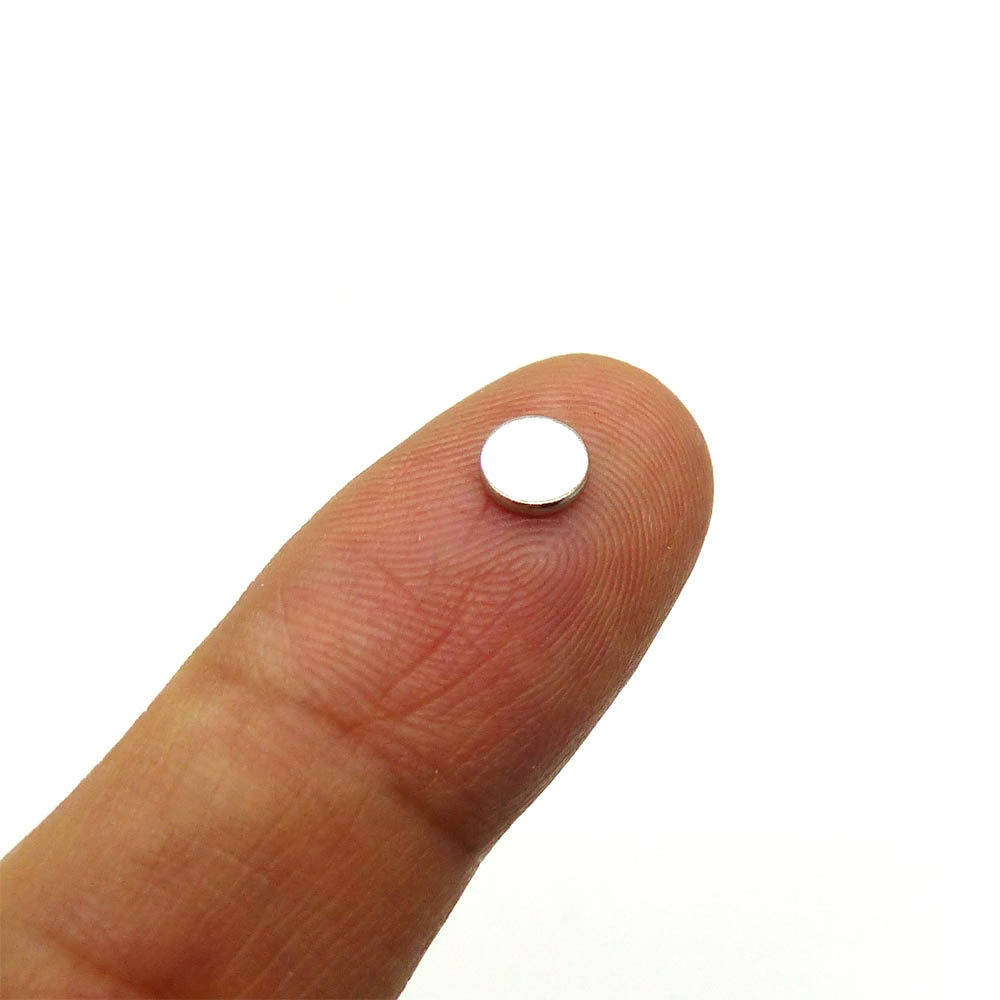

Do those magnets have a strength or size rating of any kind? Else we could experiment as you did, or use exactly the same magnets. Source? Amazon?
Ron
I bought them from a company called Panduro, but not sure if they export:
https://www.skapamer.se/stark-magnet-5-mm-10-st (you should be able to translate it)
They are definitely neodynium though, no techspec on them i can see.
PS: These look similar, not sure if they are as strong or not;
You can always use 2 if not strong enough (side by side, not stacked, you sont want them interferering with the trucks)
You can get the magnets online om many different dimensions. Just search "neodymium button magnets". I buy them in 25s or 50s for use in containers to keep them stuck together in a well car. You and also get them at any Harbor Freight store in the US but you do not have a lot of sizes available.
I just thought of something.. if you have some goggles, a strong vice and wanna live dangerously then slowly crushing a neodynium magnet will produce lots of little weaker smaller ones as they are super brittle... but as i say (disclaimer) PPE is hightly recommended as they can literraly explode😆
(Although most of it sticks to the vice... and anytrhing else metal.... light fittings... etc, (but you certainly don't want it in you))
But dont heat them or hit them as it kills the magnetism... as does crushing them but hey is all in one go. I would not even bother trying a hacksaw.
