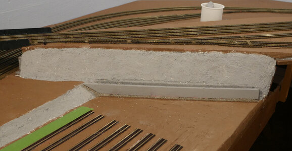

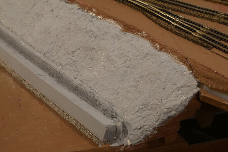

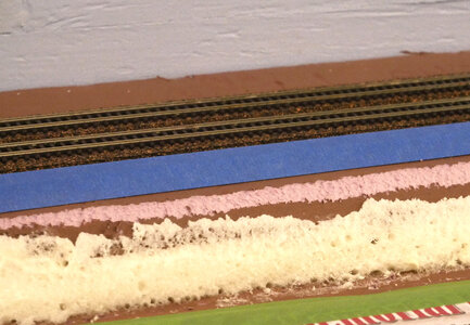

I have a long area that consists of 1/2" rigid foamboard smooth & 'shaved' with expandable foam (also shaved down) on an incline that I'm not sure how to treat.
Go over it with hydrocal or brush full strength PVA glue and sprinkle with medium Talus.
See the photos. (The 2nd pic, note the much darker 'gray' when I painted the expandable foam)

Spackle, or plaster cloth, drywall mud (it will crack in places but you can add a second skim coat, or just cover the cracks with ground foam and bushes), Woodland Scenics filler products (I forget the newest versions, but they're there)....
I had a recent bad experience with WS plaster cloth (which I was warned about, but I wanted to try it). It's too thin and wraps back around itself. It also wound up not sticking after setup time. I thought about hydrocal, but I was concerned about the inherent 'mess'. :(
Not sure what mess you are experiencing with the hydrocal? Unless it is the fine dust when you measure it, however once it gets in the mixing bowl you should be good to go.
I think it is great stuff, given a bit of patience and maybe practice. I spread mine with a rubber kitchen scraper, or if the consistency is right will use my fingers in the later stages.
May be easiest to go with the glue. However, I used some of the expandable foam on one of my layouts and say a year later noticed some shrink/swell with the foam product. If you use the hydrocal over it, you could nip that potential disaster in the bud.

Any issue with painting the foam 1st to see the effect, then applying hydrocal over that?

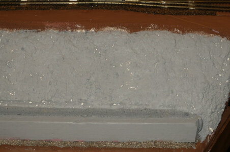

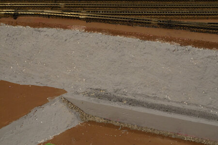

This is how it looks now, the area on the left was just painted, the rest pretty much done
I think the most important part is mixing. Sprinkling it on the water and waiting for it to sink then sprinkling more is the key, I think. The bowl could be swirled too. I don't recommend any stirring unless it absolutely will not absorb water on its own, the less stirring the better.
hope this helps!!!!!!

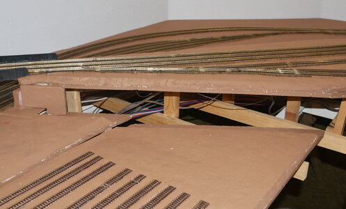

Grade of the scenery,not the track.

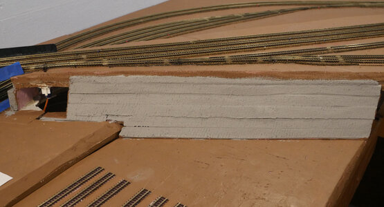

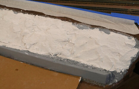

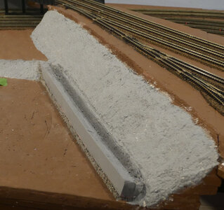

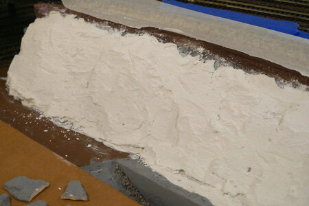

See these pics of the new area that I am tackling. This was done with outdated Sculptamold that turned out looking like cottage cheese.
The 'rocks' were too 3D for the size of the area. The area towards the bottom is rigid foamboard filled in with expanding foam that pushed out the foamboard at the base when it expanded.

This is with Hydrocal applied and some initial detailing (thou not much);
