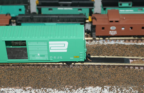

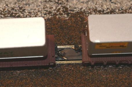

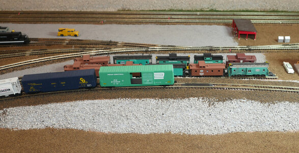

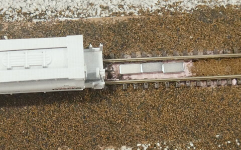

Long story short; the 'trip pin' of the lead car doesn't appear to be opening up when coupled to the 2nd car at the crest of the hump. Separately that trip pin does open when not coupled, but together it doesn't appear to be moving. thou it's hard to tell. One does, the other doesn't.
I've move the uncoupling magnet 'up' closer to the crest, but that hasn't changed anything.
Now if I push the string of cars with my hand the cars usually uncouple by the 'jerkiness' of my hand (for lack of a better term).
The uncoupling magnet is 1/2" from the crest. Lastly, I believe I made the crest to 'broad' making matters worse. But that is reaching for a reason this isn't working. See the attachments.
Hope all of that made sense.

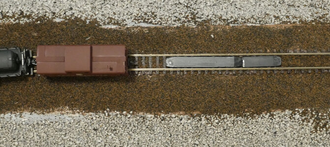

I moved the magnet up again another 1/2 to 3/4 inch just past the crest and it improved uncoupling. Up from around 25% uncoupling to around 75% of the cars.
With the MT magnet 50x7x3mm (measured) cars now separate at the very end of the magnet meaning to move it up further will require a longer or just more short magnets.

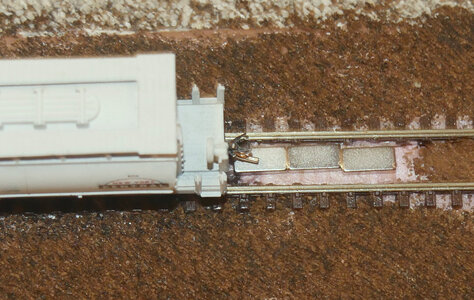

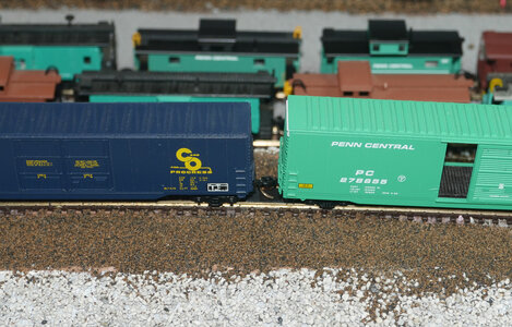

I received my 1st set (of 2 sizes) of Neo magnets I ordered from China (a week earlier than the earliest estimate no less).

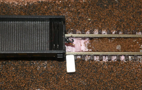

I tried these Neo magnets and they pull the couplers together no matter which way I placed the magnets. Instead of uncoupling they do the opposite. I tried taking some pics but it doesn't show up as well as I would of liked.
Compare those w/ the 3rd attachment. MT's magnet works, these super magnets do not. I even stacked two and other then it was stronger (probably because of height) the 'trip pin' still gets pulled inward, not outward on both cars. (Those magnets were not secured down. When the trip pin came close enough the magnet lifted up to the pin.)

I'm guessing here, but I believe the issue is with the alignment of the poles of the magnet.
I believe that the MT and other magnets that are designed for uncoupling have their poles aligned perpendicular to the tracks, meaning a north pole is near one side of the track and the south pole is near the other side.
Metal is attracted to each pole of the magnet. If your new magnets are oriented such that the poles are parallel to the tracks, or if they point up and down, then they will not uncouple.
To uncouple, the trailing coupler of the leading car is pulled left, while the leading coupler on the trailing car is pulled right. If the magnetic poles are both in the center of the track, then both couplers are pulled to the center of the track.

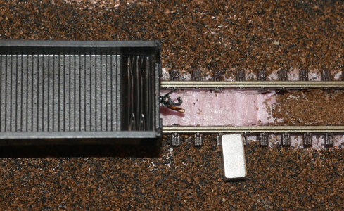

In my situation, magnets can only be between the rails as they are now with a MT magnet, or outside the rails which I did try, but since they weren't glued down the test was meaningless. There is no under the table access since this (the crest) is up on a raised portion probably four inches above the table level which consists of 3/8" ply and 1/2" rigid foamboard.
The poles of the magnets are the top and bottom of each one. Being the size is so small, it's hard to reposition them sideways, but it made no difference, they just won't work.
I got the link and suggestion elsewhere to try those. :(
I temp placed two stacked magnets against the rail to see what happens. Nothing!

Can you place the magnet inside the rails when it is perpendicular like that? If not, you can shorten the magnet a bit by chopping off a small amount from one side. That won't damage the magnet, and it will rule out the magnet as being the problem.
It's possible that the magnet being on the outside of the rail isn't quite strong enough. it's also possible that the poles in those magnets are oriented "up and down" or "front-to-back" rather than "side-to-side."
This is a really good video. It's all good, but you can jump to about the 9:00 minute mark to see what I'm talking about with getting the magnetic poles under each rail. Again, this is HO scale, but the concepts are the same with N scale.
I would have to try it.
I received the MT magnet set (2) and discovered that the N & S poles are centered around the sides of the magnets which makes sense based on the direction the 'trip pin' is facing.
On these small silver bar magnets the poles are on the top & bottom making them semi useless unless one positions them standing up om their side which isn't practical in my situation. The cost difference in nil.
The solution was to cut one in half and extend the length which seems to solve most of the problems. It needed a longer reach past the crest which was the last problem. I still have a few exceptions which I'm dealing with the specific cars.
