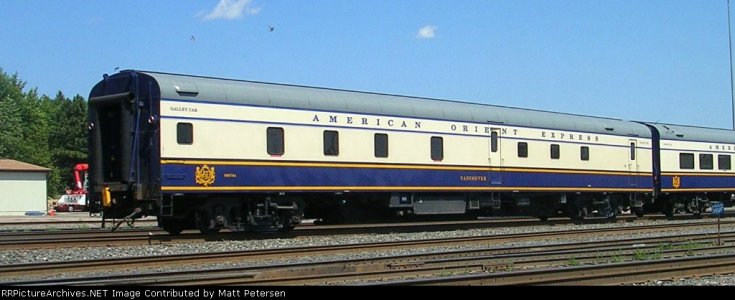

I'm curious, what is the American Orient Express?
They look great!
You're asking me !!!!!
