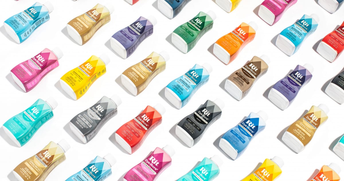

For coal I used crushed walnut shells. It was very brown and didn't look like coal though. I found out it can be dyed with Rit fabric dye. Now I have black coal. Look up proper dying technique because it first came out sort of very dark purple but a lady at work showed me the right way and it can be made black.
You could always puta small test area down. secure it. Then use stain and stain it. Minwax does make a black stain. Rit fabric dye as well, or a paint thinned down
tried with thinned down paint, but possibly was too thinned as it took a lot, and a long time to dry. Of course I used oil paint.
So, what is the proper way to use the Ritz's dye??
I didn’t add salt, enough heat or use enough dye for the quantity of shells I had.
I used a cloth in a strainer to get them out of the dye, skipped the post rinse and dried them on a cookie sheet in a toaster oven on low.
Use the household cook’s pan, strainer, cookie sheet and oven at your own risk. If anyone asks, I don’t know nothin’.
