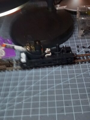

Ok, over a month since I last posted that I worked on this mess...
As I posted in the Coffee Shop, here's the base set up with the couplers and otherwise fully operational:
The couplers catch about 2/3 to 3/4 of the height gauge which is fine for my circumstances.
Then I decided to remove the flash that the shell still had from manufacturing:
I also removed the windows and single horn that was left on it and decided that with the flashing gone, it needed to be repainted:
Then it would need to be stripped if I were to save any detail on the unit:
As you see, this is where I left off. Most of the blue is gone and could only be removed after a bath in mineral spirits. The only thing I had that would touch the yellow was denatured alcohol. The paint was mostly scrubbed with toothpicks. I know I'm spending a bunch of time on a model that isn't worth much, but I figure better to work out how to do this on a cheap model than wasting money on redoing and botching up a good model. Not quite sure how I want to paint the thing yet. I need to locate some pictures of working loco's.
