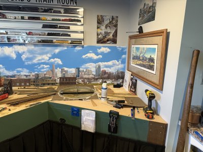

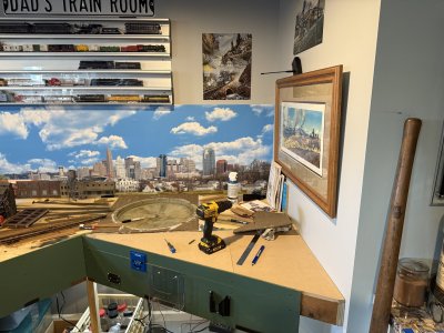

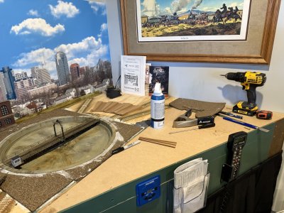

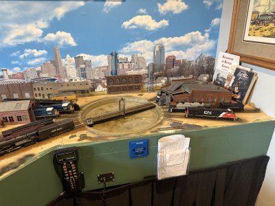

Here is my new project. I am working on a new Roundhouse that I am 3d printing. This is going to be a big project that needs more room. I have to elevate the turntable simultaneously with the cork since this new design roundhouse incorporates it. The new roundhouse will be six or seven stalls, depending on how many I can fit. There will be two additions to the back of two stalls to handle my Big Boy and Cab forward. I got a lot done today.
The 3D printer is working hard to print the many pieces this thing will take.
In the pictures below, you will see before and the new wedge I added today. Everything is back together as far as I can get it for now. I can't do a lot more until my printing gets done.
I never realized what a task this would be, but what else do I have to do? The print time is going to be around 70 hours. ( I'm estimating) I am taking my time on this one because I plan to add a lot more details to this.
Stay Tuned!

Are these photos in order? What are the weights for?
Yes, they are in order. the first is what I had to the last one that shows the extension. The weights are for pressure on the turntable. I set the turntable in place with a small film of caulking. If you ever put one of the Walthers turntables in, it is a chore to put their screw clamps in. Doing it this way makes it a better install and is easily removed if needed.
