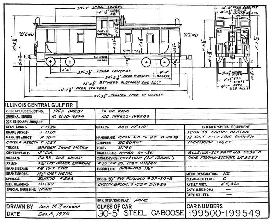

If only, because the roof walks are removable... Maybe you could frankenstein the Athearn and the Tyco together. The Tyco does have the more accurate windows. The Athearn has better truck and coupler hardware.
This one is better than the Blue Box stuff in general, I never had the caboose. I did like the tank cars, though. I still have an unbuilt one, and plan to put it together this year.
Dimensional drawings of the ICC Wide Vision caboose (but not necessarily the ICG version) are also available in the June 1974 issue of Model Railroader magazine, page 35.
