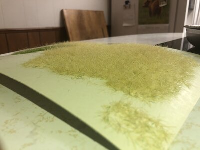

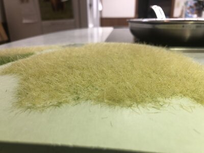

So you got me thinking so I did a test, same applicator and I used static-tac glue.
The green is 4mm and 7&12mm straw.
The first thing I did was sanded the paint off the supplied fancy ground.
spread the glue pretty thin.
Im pretty happy for the first test.
Kinda hard to see from phone pics. View attachment 163356View attachment 163357View attachment 163358View attachment 163359View attachment 163360View attachment 163361
Well I think we cab definitely say you got it :)
do not forget to show us the result once on the layout as well, nicely done

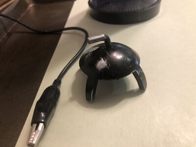

Hey folks, I'm back on this thread again :confused:. My Woodland Scenics Static King has been working great for the past few months, but while I was using it this last weekend, the solder joint between the wire and the alligator clip came undone. Will this affect how well it works?
Just like any broken/loose solder connection - either will work, work intermittently or not at all. Carefully solder it back together making sure you have a good mechanical connection and no 'cold' solder blobs.
