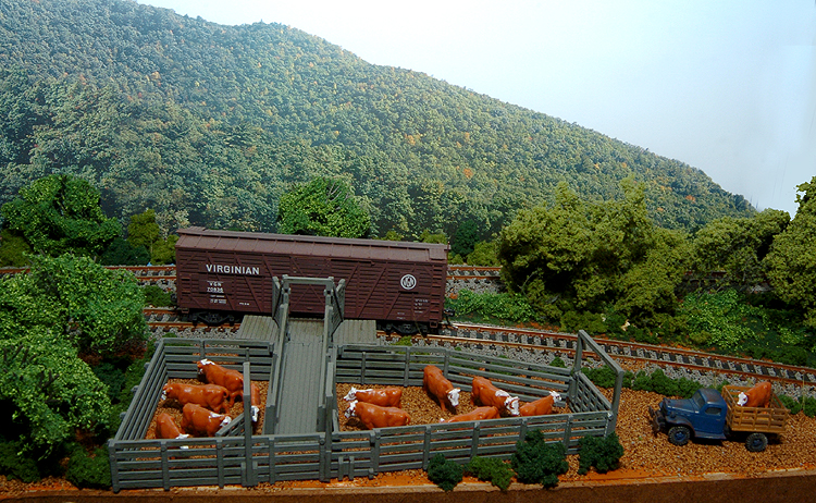

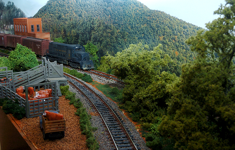

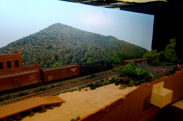

Looks good!
Also looks like it took FOREVER to do all that ground cover
Thanks. It didn't take as long as you might think. Maybe 3 or 4 hours spread out over a week's time. I found a way I can cover 5-8 square inches at a time. I pull some Poly fiber out into a thin flat piece about 1 or 2 inches wide and maybe 3 inches long and slightly irregular shaped. Then I shoot one side with spray adhesive and drop it, glue side down, into a tray of ground foam. Shake off the excess and glue it down on the hill. Bingo, I just covered 6 square inches in one move! Then I add some random taller weeds and bushes and it's done.

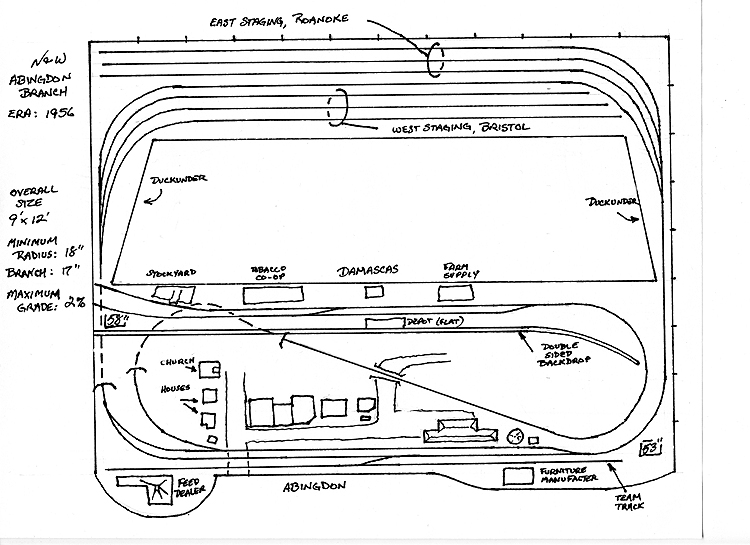

In it's final configuration, I have been operating this layout for about a year and it has become rather mundane. The main feature, the Abingdon Branch with it's only one train a day in each direction doesn't provide enough operational interest. Today's run is pretty much the same as yesterday's and so on.
Plus, like most I suspect, there are things about this layout which I wish I had done better and would like to improve on and some other things that have become nagging problems that limit operation. I intentionally used a too small minimum radius to increase the length of tangent track and that has become a problem. The next layout will have broader curves.

That would require using steam locomotives and the turns are way to tight for steam. That's one of the problems I mentioned that will be improved on the new layout.
