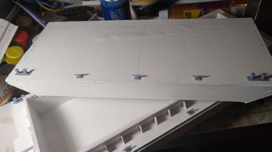

I made a little bit of progress. Added gussets to the outside edge of the hold.
Ok, so this isn't really part of my scratch build but I do have a paper version of it coming along too. I'll post pictures later. I'm hoping to print the double bit bollards and cleats during lunch today. I'm opting for sla 3d print of these details since I haven't figured out a way to make the cleats yet. I think I have some ideas for the bollards.

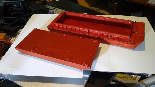

Added a black acrylic wash, painted the cleats and bit bollards yellow. Weathered with some pan pastels but that disappeared with the clear coat as expected. Next up is some rust.
