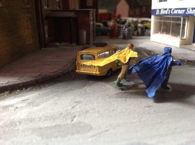

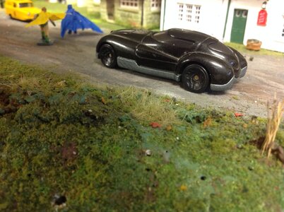

Jaz….great puddles..water…
I love your village scene with the VW…
Almost expect to see Stan and Jack from On The Buses….!
Oooh what a great idea…I’ll have a look…this would be classic
i can give you only fools and horses
