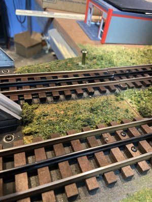

I made my double track system with Kato HO unitrack. I wanted a way for the trains to cross between the two and since Kato doesn't offer a double cross-over like they do for the N-scale stuff, I had to make my own. Took a look at the Kato HO unitrack "catalog", which is basically a flyer, I bought what I thought I needed.
I wanted #6 switches since this was on the main line.
I ordered a left and right side on the first order and the corresponding switch machines since they are separate. When they came in, I found that I should have ordered two rights or two lefts instead, so I ordered another left and right.
Well, that didn't work either since these switches end up being way too wide to match the standard spacing of 19mm that Kato uses.
So, after searching the interweb, I found that the switches not on the BS catalog are what I really needed.
So, I have an extra #6 switches for later use.
