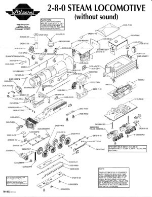

Front truck derailing could be from not having enough downforce. There is a spring on it that may need retensioning (bending).
For the tender trucks, yeah wipers suck. Athearn's consolidation came with axle end pick ups on those trucks. They sell them. If not listed on their website, send them an email.

Kusojiji thanks for the reply. I will try to call Athearn tomorrow; but I would have assumed they would show the power pickup parts on the tender picture​

Kusojiji, Thanks for the reply. I will be contacting Athearn Monday to see how their tender trucks work for power pickup. I looked at Athearn trucks parts online and they didn't show anything. Hopefully they still have some and they will fit. The axle wipers on the Bachmann engine barely make contact with the axle. The Athearn parts picture doesn't show any pickup connections, so I will wait and see what they say. Haven't tried putting more pressure on the engine lead trucks. Not much point if the engine doesn't run. I don't like buying something "new" and having to rework it to make it run properly

I don't think they were listed on the website so I sent them a question on their contact form, link at the top of their page. I also bought the consolidation's spur gear since I figure they would be prone to wear and would become unobtainium.

I order 2 pair today. Hopefully I can make them work
