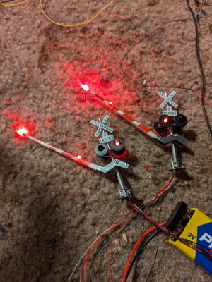

Later I added LEDs to the gate arms to make them more realistic and entertaining! I added prewired SMD 0402 and 0603 red LEDs with resistors to the gate arms and I super glue the LEDs on the arms. Also try to make it so that two of the lights on the gates flash in harmony with the signals while the third light stays on!
They do make crossing gates with lights already on them but I prefer to add the lights myself.
For power, I use 9V batteries and I recommend you use that and make sure you have at least one resistor for your signals (I'd wire it to the cathode, the red wire, rather than the anodes (black wires.)

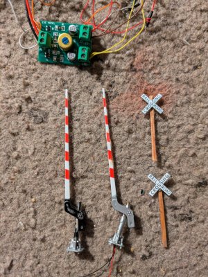

Some of my signals had some problems including burning out the LEDs and so I've had to replace the signals altogether so now I'm trying to be really careful with them! I've had some frustrations including trying to get them wired right, keeping the LEDs on the gates, the wires getting tangled, and as I said, the lights burning out and having to replace the signals! Thankfully so far these are less expensive than operating signals from other manufacturers!
I also ended up learning you don't need to put two resistors on one signal, you only need one. Make sure you put the resistor on the red wire.
Hmmm, LEDs should never burn out. Do you mean the main LEDs in the signals, or the LEDs you've added on the gates?
So if your are burning out LED's, you likely have over-current and need a different resistor in series (I did see you had them there!), optimally with a zener diode in parallel to clamp the voltage. You should not be burning out LED's. Of note, the Resistor you use may not be a 470 Ohm one...depends on your setup and diode voltage - I would do the calculations for your setup. I would suggest getting a breadboard and testing.
I'm not entirely sure what happened. But yeah it was the main lights. And I did add resistors to them. I learned many years ago never to wire LEDs without resistors! I did give up on LEDs for a while except for Busch crossing signals, which already come with a flasher unit with resistors in them
Otherwise I preferred incandescent lights.
Anyway, despite me adding resistors, maybe I added too many when I was trying to decrease the chances of burn out. I would tie two resistors together and put them on one of the anodes and repeat for the remaining anode. I wasn't yet confident enough to just use one resistor on the single cathode! Maybe what happened was the metal parts of the resistors were touching each other and that may have made them stop working. I also extended the wires by adding more wires (I use 30 gauge, that's the thinnest I can purchase, I tried looking for 32 gauge, maybe I didn't look hard enough or I couldn't afford them.) I also wired them to a 12v AA battery holder, and now I try to avoid doing that anymore even with resistors added! I mean you can use 12v but I recommend just using 9v batteries to be on the safe side.
And after hesitating a while, I decided to use only one resistor per signal, no added resistors. And I put them on the cathode and so far it seems to be working better.
Should also be careful, those signals are a little stronger than the Busch signals but cannot take a lot of punishment! I've also had the lights disconnect from each other and not work as well unless I pushed them back together and they would light up again if I could keep them together.
But so far things are okay. I haven't needed to replace my signals!

How were you tying the two resistors together? If in parallel, then you'd be halving the resistance. One resistor on either the anode or cathode is sufficient. And definitely need to insulate the bare conductors. I've blown up decoders because I didn't do that in my haste.
Insulation. That's what I'm realizing I need to do. I do have some insulation material I bought a few years ago and plan to use it, I just don't know how yet.
I tied the bare parts together. If that's halving the resistance, in other words, cutting down the resistance (paraphrasing here or whatever I'm trying to say) then I better not do that anymore, I'm only doing more harm than good! I wish I knew that sooner! That's not your faults though, for one thing you guys didn't know because I didn't tell you. But that's it on tying two resistors together, another what-not-to-do for me!
Thanks for all the information you're giving me, I need to know all this so I can manage my signals better and make them last!
Would electric tape also work or no (insulating the bare parts of the resistors?)
Edit: Okay look in the upper part left of the following picture to see what I mean by tying two resistors together.
Nevermind anything else in the picture, I took this picture mainly to show WeHonest what's been going on. In case you're wondering though, the signals stripped of their crossbucks are the signals that don't work anymore! But thankfully I found another use for the crossbucks and gates.

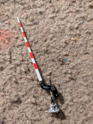

I was able to convert this to a crossbuck-less gate with a shorter pole, the kind you usually see at some crossings with cantilever signals! I plan on using cantilevers and I am hoping WeHonest will make cantilevers modeled exactly after these ones made by Safetran (or RACO)

Will: Electric tape works, but will loosen up after some time. Better off doing it right and get some shrink tubing for those bare wire areas.
Also, I suspect that the LED's that died could have been from a high reverse voltage. Specification on the ones I am playing with is 5VDC.

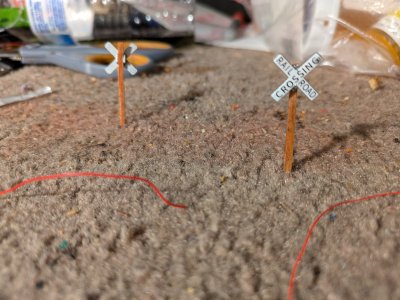

Those crossbucks look very oversized to my eye...

I was able to convert this to a crossbuck-less gate with a shorter pole, the kind you usually see at some crossings with cantilever signals! I plan on using cantilevers and I am hoping WeHonest will make cantilevers modeled exactly after these ones made by Safetran (or RACO)View attachment 262317View attachment 262318View attachment 262319View attachment 262320View attachment 262321View attachment 262322View attachment 262323View attachment 262324

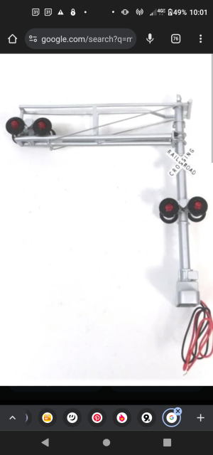

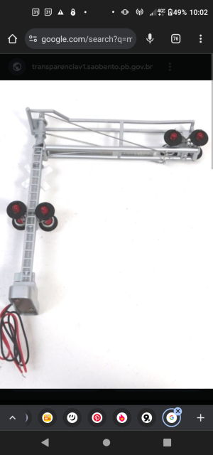

And also after these HO and O scale cantilevers made by NJ International and MTH RailKing (the HO ones are mine)
The O ones are pictures I got from Google ImagesScreenshot_20240708-100158.pngScreenshot_20240708-100218.png
I know WeHonest already cantilevers but I'm not happy with those and asked if they would make the ones that look like the old Safetran types like NJI and MTH RailKing did and they said they would try.
But getting back to my crossing gates, I decided to convert my now out-if-service signals to short-pole gates minus the lights and crossbucks so that they wouldn't totally go to waste! I showed WeHonest and they told me they got new ideas and now they make short-pole HO gates!
With lights https://www.wehonestmodel.com/produ...r-w-light-on-gate?_pos=8&_sid=ba6569de5&_ss=r
Without Lights https://www.wehonestmodel.com/produ...er-shorter-cgs87?_pos=17&_sid=ba6569de5&_ss=r
I mean the ones they've been making had tall poles and I would have just ordered those but now I don't have to, I can just use what I have! I think that's called "up cycling!" I learned that word from "Carl the Collector," who has autism like I do, hence one reason why I have trouble expressing myself and have some obsessions including with gate lights! But reusing my gates from my dead signals is a big money-saver and I like short-pole gates better anyway if there are no crossbucks or main lights!

From what I could see from your picture, it looks like you had them in series, which adds the resistor values together. If you had tied both ends together, then it would have halved (or less, depending on value).
Series
Rt = R1 + R2...
Parallel
Rt = 1/R1 + 1/R2...
I don't use black electrical tape as it makes a gummy mess and comes off. If too late to use heatshrink, kapton tape works great and is thin enough to be used to hold stuff down without causing an interference issue.

OP, do you understand that a resistor is not a fixed quantity? That they come in different values? Do you also understand Ohm‘s law? It is a simple straightforward formula. Use the formula to compute what value of resistance you need. Then be aware, as other posters said, of what happens when you put resistors in series or parallel.
I guess I have a lot more to learn about resistors than I thought!

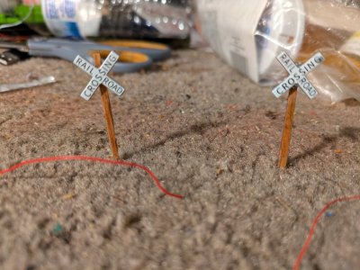

Admittedly they are. I was hoping for smaller signals like NJ International did. And this is one reason why I hesitated to buy WeHonest signals at first. I wanted to know their sizes and thankfully WeHonest, at least on eBay does provide measurements to their signals. And I measured signals I got from others
