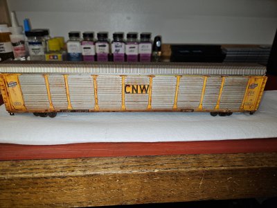

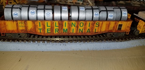

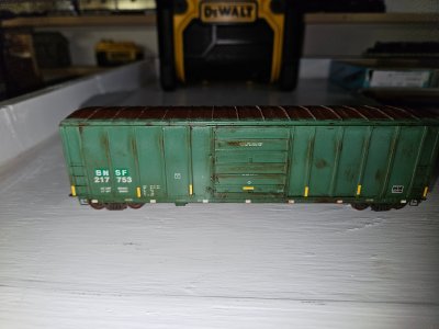

Here are examples of Light, Medium and Heavy.

There is 3 types of weathering in my opinion. Light, Medium and Heavy. Each person has their own taste. I do all 3 types to please as many as I can.
Hope this helps.

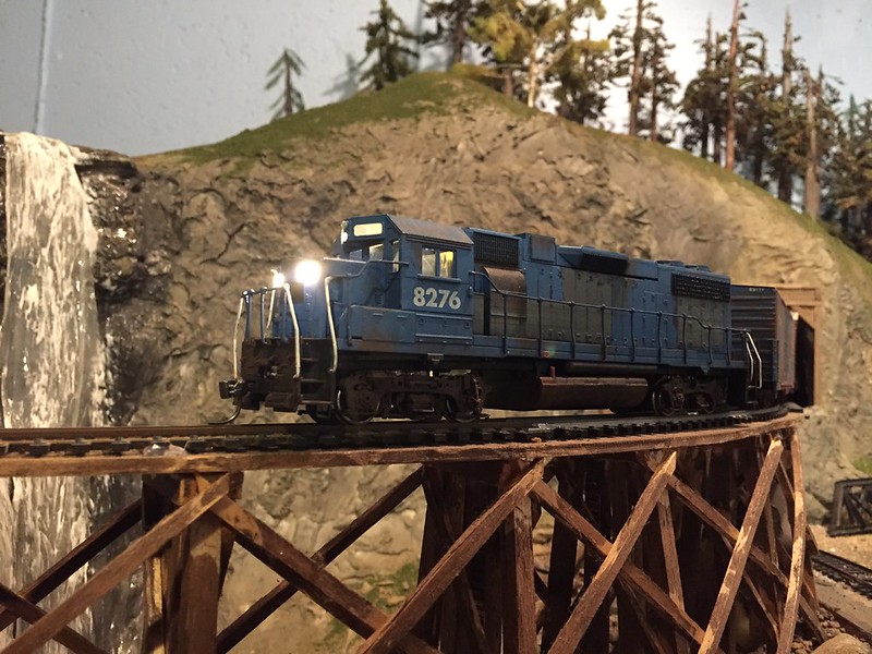

I have had many offers to either buy or ask if I do weathering when running trains at a show with the club. I had 5 offers on this engine at a show.
