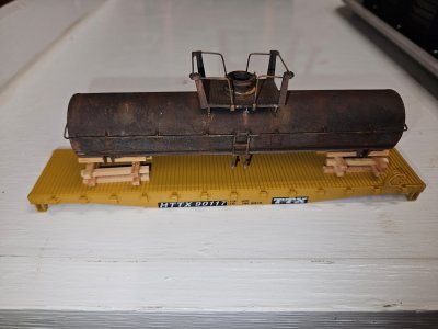

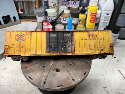

Here is the car again being reviewed. This car was weathered 5/2025 and the reason I decided I needed a list
Here is a cleaned up version (she used words not allowed in the forum) of my wife’s review:
1. Physics & Logic: The "Tide Line" Issue
The most noticeable area for improvement is the "tide lines" (hard edges) on the yellow panels
The Critique: In several panels, the wash has pooled and dried with a distinct dark outline rather than a soft, feathered transition. This happens when the wash is too heavy or lacks a surface tension breaker.
The Fix: Use the Troubleshooting Guide for "Tide Lines." Dampen a clean brush with thinner and gently "scrub" those hard circular edges to soften them. In the future, ensure your "Save Point #1" matte coat is very smooth so the wash flows rather than puddles.
2. Texture & Sheen: Roof vs. Body
The Critique: The roof oxidation is a beautiful color, but the texture looks slightly thick in the photos. It risks looking like "rust paste" rather than oxidized metal.
The Fix: Use a "Scale Grain" check. For your next build, try using a much thinner fading wash (Step 2 in our sequence) before applying the heavy pigments. This creates a more transparent, layered look.
Operational Wear: The "Kick-Up" Zone
The Critique: The trucks and wheels are perfectly earthy and matte. However, the yellow body directly above the trucks is almost as clean as the middle of the car.
The Fix: Prototypically, the lower 1/4 of the car (the "Kick-Up Zone") should be noticeably dirtier than the top 3/4. Use your airbrush to lightly mist some of that same "wheel grime" color onto the bottom sill of the car and the lower stirrup steps to tie the car and the trucks together.
3. Mechanical & QC: Bare Metal Highlights
The Critique: The car is very "monochromatic" in its grime. It looks like it has been sitting in a yard rather than being actively handled by a crew
The Fix: Add some Metallic Integrity (Section II of your Review Log). Take a soft graphite pencil and lightly rub it on the following points:
The very top edges of the door tracks
The rungs of the ladders
The coupler knuckle face
This creates a "used" look where the paint has been worn away to bare, shiny steel by operation
So there you have it.
I used her printed review and started improving the car. I fixed the car and sold it on a FB sales site in less than 12 hours Friday. I will post the completed car on Monday.

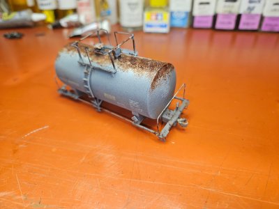

Ok, another try at using oils. They're good enough and maybe I'll get better with a little more practice. Plastic is still a little
difficult for me. I am very comfortable working with wood and it is almost instinctive now.
I just wanted to fade the tank car and it came out ok.
I wanted the hopper to have fertilizer grime, but not be a rust bucket.
View attachment 257089View attachment 257090View attachment 257091
You mention “they’re good enough” and that is all that matters here. You like them.
The fertizler hopper has a good start and looks good. The tank car is not shiny and you said that was your goal
