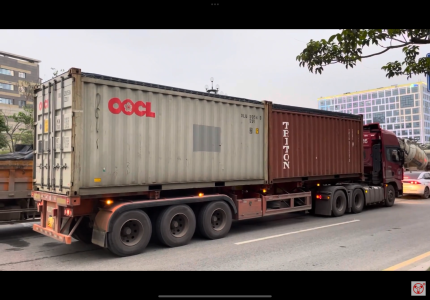

Here is 1 of the 3 40’ OOCL containers I will be working on
Just inspected and cleaned with warm H2O and some dish soap
Next I hit the container with a spray of 91% Isopropyl Alcohol
I have been searching for online photos of containers that have some noticeable weathering. Most containers are in good shape and relativity clean. This photo is from the Alamy site that has free pictures. There are some touches of rust. I am going to try to closely follow this inspirational picture
Here you go
Another spray of clear coat to be added and contemplating adding some earth color to it especially for the bottom edge of the container
