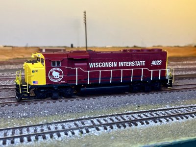

A little interlude to compare the differences that photographic equipment makes. I got a new phone/camera early in the week.
The subjects are my single-sheathed, outside bracedFirst up, a photo I’ve shown before, from my iPhone 11:
And now, from my new iPhone16, same setting and location as before:
Well, the new phone is giving me higher resolution, but you have to zoom in pretty tight to tell it.
Color rendition is pretty accurate on both. The color difference in the car between the pictures is real - it’s two different cars, and the one in the top was airbrushed with more of my rose-colored fade coat (look at the B&O capitol dome).
Not necessarily “earth-shaking” overall difference between cameras, but when you zoom in closely, the resolution difference is much greater than I initially appreciated.
