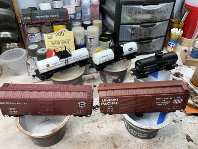

I have a 1st time client that has forwarded me 1 diesel and 12 pieces of rolling stock. I have a method to my madness that I call my normal procedures. I have had requests here via forum email and many requests on FB as to what those normal procedures are! I will post pictures of my process for 5 cars as I move along. It’s nothing spectacular or crazy earth shattering but it works for me
The five
When I receive a model I first put the name of the modeler with address and number of pieces to return on the box it came in and that I will use to return the finished cars
No picture!
Each carton holding the model then gets a piece of painter’s tape with the modeler’s name on it and the price of the finished item
I then open and inspect each car looking for “obvious” missing or broken items. If something is found I will take a picture and text it to the modeler
I learned the hard way $$$ on this procedure, so it’s a must be done thing
I then remove the trucks and wheels for cleaning. I have various ways that I have tried for cleaning. I have air brushed Isopropyl Alcohol (IPA) but that became too wasteful during Covid when the price for IPA exploded. I have separated the wheels from the trucks and dipped them in a bowl of Isopropyl Alcohol and then brushed them. Now I take the wheels off and hand clean them with a mop brush dipped in IPA. Same with the trucks
Here is the mop!
That is what I am doing today. In groups of 5 I will inspect and clean 35 cars. The fading of the cars will start tomorrow and hopefully be done by Sunday night.
Between bouts of fading I will weather/rust the wheels with a brush. I will ream with a Micro-Mart Truck Tuner
the wheel holes on the trucks
and then weather the trucks
have a great day
