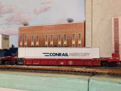

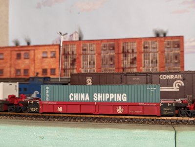

I also like the heavier stuff on my layout. Also prototypical when you're modelling part of Conrail's Kaleidoscope era. I did a set of Walthers 305' thrall 48' well cars light. Bugging me too much. I mean, the prototype is heavier than what I have now, just debating on more airbrush, or move on to the Tamiya powders. I still need to get new applicators for that stuff.
I wish I had the room to do the curves I want. Limited to a full room shelf layout, 53 inch height; Hinged shelves on both doorways, and soon to be removable 4 foot bridge across the window.
I'll post the prototype pics of those Thrall cars and a pic of where I'm at in a few.

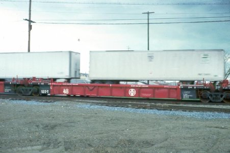

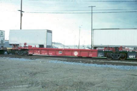

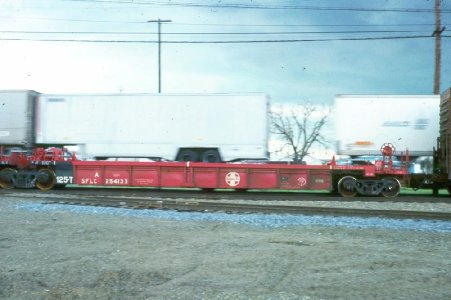

Forgot to post these last night. Prototype photo credit to qstation.org , Gregg Fuhriman.
Cars A, B and C
All I've done so far, was super diluted white airbrush to fade, which wound up getting wiped out by the following diluted Smoke airbrush. Airbrushed from upside down, in the direction the spray would represent on the cars in the prototype. Both Vallejo mixed with 91% Isopropyl. The bogies are straight from the bottle Tamiya Black panel liner, 3 coats. Wheels brushed on with Red primer and German Dark Brown.
Nowhere near complete, suggestions welcome.
I was thinking going back in on the fade with the Tamiya Snow weathering powder. I feel I can better highlight those areas AFTER the bulk of the weathering is finished to better match the prototype. I can also add a little to the bogies to closer match the prototype as well. I have not weathered the tops yet; Have not yet found some topside photos of these.
-RC

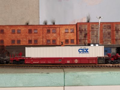

I received two Everest Well cars and this is the first of them, as I said in the RPO not well detailed (for $12 you can't expect museum quality) but they run really well.
Weathered the interior and trucks, the exterior will have some fading and light weathering applied after the decals have been added, and no, I don't weather the underside.
No matter how I try, getting a decent rusty look still eludes me.

You can try the burnt umber as Tom suggested. Buy painting the wheel face it'll give it that two tone look giving dimension. A couple examples.
These are some of my very first weathering projects.
Converted a couple TYCO cars to screw in bogies, (I designed a glue-in, 3d printed adaptor, to convert snap-in bogies to screw in; It's free, so let me know if you want the link to the file), and mounted coupler pockets to the car body.
Then I used Vallejo Smoke thinned down in the airbrush with IPA, and gave the cars a grime coat. The roof is done with a mix of panel liner in black and brown. Here was an experiment; I left the dust on the top of the car to wick the panel liner into.
Forgot to mention, details were hit with Tamiya Brown panel liner, and cleaned up with X20 on a fine tipped q-tip.
Last but not least, oil paint for the rust streaking. Dot, drag down with a clean brush, then apply weathering powder in rust and orange rust. Sealed with Mr Super Matte Clear.

I know you said you don’t weather the underside, but I think it has a good rusty look.
Presuming your dissatisfaction is with the blue sides, try a thinned spray of Vallejo burnt umber. For rust streaks with substantial texture, try unthinned artist oil, burnt umber and raw umber colors. Unthinned, it will be tacky for a couple of days at least without applied heat or drying).
Come back the next day and apply suitably colored pastel chalks or weathering powders to the areas done in oil. You can dab it on, but my best results come from flicking the bristles & chalk dust at the damp/tacky oil-painted spot.
