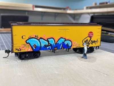

by the way here is a absolute first try with pens on a H0 Scale car :D
That's a subjective question, what colour is the car ? lighter cars need darker colours, and darker cars need less and more toned colours, are you heading for a rust bucket, is the car wood or metal, what type of car is it, flat, gondola, spine, box etc.? how "old" is it supposed to look, whats the general environment the car would usually travel through, and then there's fading. There's a whole range of things to consider when you weather something, 5 colours simply isn't enough

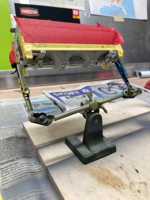

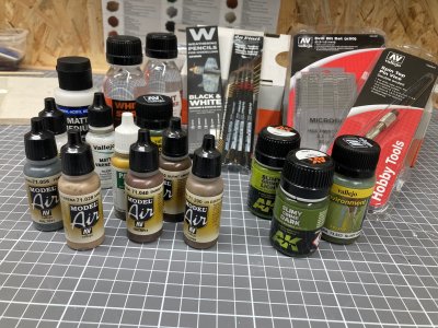

Well thank you to all your replys about the colors and stuff. i was at my local airbrush shop on Saturday. well it escalated quickly i guess :D
So i started my hopper project for the Walthers build off. i dont know why but i like competition even if iam get dead last, but iam motivated to try it.
what can i say, if you waterdown a valeyo air color dont use too much water haha. will try it again with almost no water, or should i maybe use the thinner?
question, if iam using a thinner, does that mean the color it self stays in its state, but the colortone will thinn? sorry dont really know how to describe, but if you add water it gets more floaty i guess, does that also happen with thinner?

When in doubt with thinning go with the paint producers thinner.
well i will try it out.
for me the vallejo waterbased airbrush colors are pretty covering, if your working with the airbrush.
but i think the air colors are thinner that at least what i discovered when i saw the air colors the first time. so i will try it without thinner.
I only use Vellejo and tru colour paint, Vellejo I have never thinned when painting
