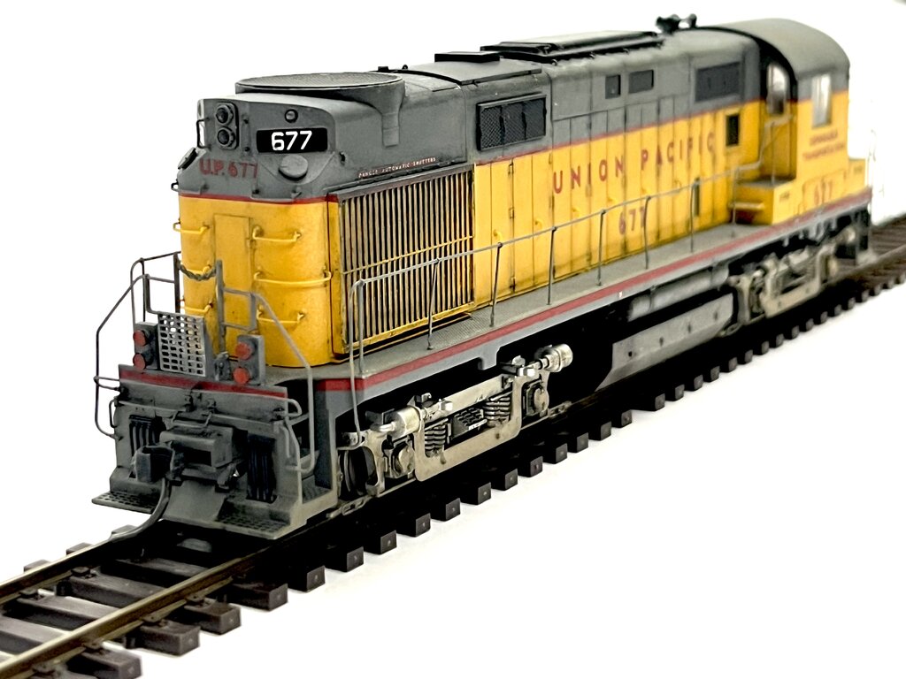

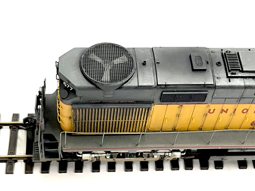

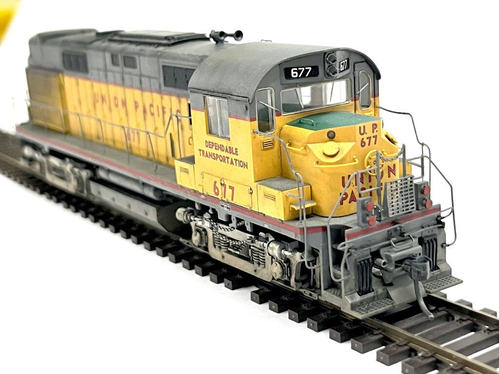

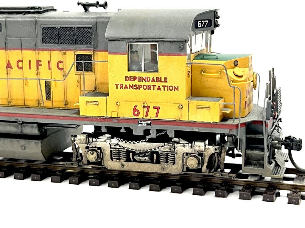

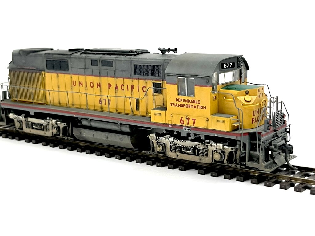

Thanks a lot guys, for the roof pictures! In the meantime, I have repainted the dark roof and applied a much lighter weathering. What do you think now?
BTW, this is a heavily modified Proto2000 model. It has:
  • LED lights
  • ESU Loksound with a powerful passive radiator speaker
  • ground light
  • cabin light
  • stay-alive Capacitor
  • Remote couplers front/rear
  • motorized radiator fan
In the next days, i will start a new thread, where I can share some details about this mod.
  • LED lights
  • ground light
  • cabin light
Looks great! For my personal taste, the weathering is right in what I'd call the "Goldilocks zone".
That looks really nice, a huge improvement.
My only minor quibbles:
1. Add a little dust/dirt/grime around the lowest parts of the frame, particularly above the trucks. That area seems bright compared to the rest of the model esp above the rear truck.
2. Paint your handrails! I don't model UP but a quick google shows they should be white in the grab areas.
Thank you!
I’ll leave the handrails gray, all photos show the prototype RS27’s with gray handrails, not white
