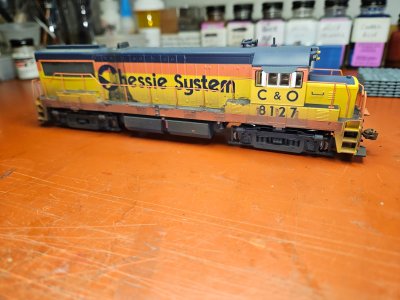

How do you guys photpgraph these things? It doesn't look all splotchy and textured like this IRL.
Mostly done. Need to repaint the MU hoses and cut levers (god those were a pain and you can't even really see them), and the decals didn't stick to the number boards at all! Any advice on the latter? I was debating painting them white anyway. Still need to add the wipers, but I figured I'm going to be taking it apart to re-do the number boards first anyway.
I thought the clear would knock the powder down a bit more. Fuel tank looks grayer in pictures than it actually is. Trucks look better in pics than IRL though lol.
Critiques appreciated as always. I know this won't win any shows but its a huge step up from what it was and I think its my new favorite (sorry SXT Chessie!)

I would add some earth highlights on the frame and trucks, even a smidge of light tan wash on the body. Clean some dark off the yellow step handrails, those are generally cleaner from use and safety maintenance.
"the photo doesn't look like it does in reality" - that's just a long time fact of photography
Noted, will do. Its nice to get other eyes on the pictures, I wouldn't have noticed the handrails! Gonna try to redo the number boards today too.

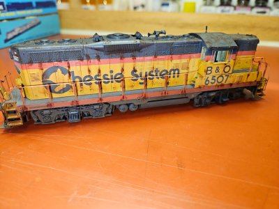

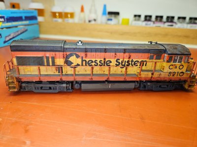

Got around to weathering the Chessie engines. First tape off windows and lights and spray with dull coat. Then added a light coat of rust.
Added some browns along the lower extremities. Maybe too much. Definitely looks good on the plow though! Its not sealed yet. Cleaned the handrails and fixed the number boards too. I think I need to paint the insides of the fuel tank just tarnished balck or something, it seems to pop in every picture.

From the few pictures I could find 4023 was a bit more dirty than 4054. So I just did a little grimy black to 4054 and a bit more to 4023. At the end the trio is together in advanced consist to utilize the drive hold features. On to the next project.

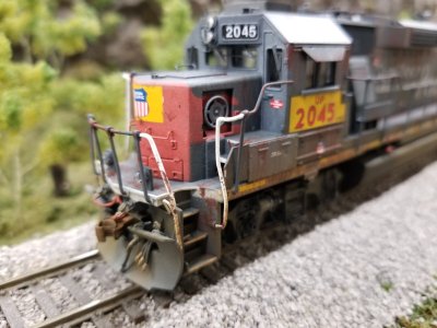

Rare natural light pics. Powdered but not sealed yet. Was trying to be gentle on this one. Added hoses, cut levers, and sun shades. Panel liner. Light fade. The powder really stuck to the trucks for whatever reason, but I think it looks pretty good in person. Not happy with the tank, particularly on the left. Right side is better for sure. Forgot to paint the filler and sight glass, need to do that still. I think I'm going to repaint the intakes too, particularly at the front which isn't showing up at all in these pics.
Critiques appreciated. Grade me like you're judging a contest.
Just one thing, that I caught myself doing as well. Typically the front and back of the fuel tank have more road dirt than the sides due to the wheels kicking up and spraying dirt (think about mudflaps on a semi). When you're weathering, you're applying it from the sides and it's easy to end up with little to no dirt on them, compared with the sides. I saw it in another progress post too, but also realized I'm guilty.
Those trucks are incredible.
Thank you.
Realized I still need to paint the cut levers yellow, and trim the hoses at the rear (I need to come up with a better solution for these, debating drilling and inserting them 1 at a time on the next loco). Also might get the handrail verticals with some powder, they look very white in these pictures. Sprayed some grimy black on the tank and trucks, which knocked down the rust on the trucks nicely. Redid the grills with both panel liner and paint. Had a little run in the panel liner on the left side which is why its messier than the right. Overall I think this came out pretty well though.
Was playing with camera settings, these are actually direct sun pictures. Iphone still seems to have added some blotchyness particularly on the right.
The couplers could use a rust color, other than that looks good. If you look at videos you'll see that most have a brownish look on the tanks and trucks than rust. I usually layer rust, then a tan/mud and lastly grimy black. The 3 tones give a nice look when they a applied in light coats. Depending where they are at also differs. Northern areas have more grimy black where south has more dirt tone.
I'll take any praise from you, your stuff is amazing.
The rusty brown powder stuck way harder to the trucks than I thought. I wasn't originally going to spray the trucks and tank and just use powders, but I realized that was a mistake since the earthy-er powders were way too bright and not well blended. I should've just started with a grimy black spray to begin with. Despite not having a real layout, my goal is to model an Appalachian setting so I tend towards blacks more than dirts anyway, though I have seen the difference you mention in photos.
I think I have 1 more set of brown MT couplers but they're reserved for the other SD60 I just picked up that has rapidos. Next time I'm spraying brown I'll try to remember to hit them. Now that you've pointed it out, its all I see.
