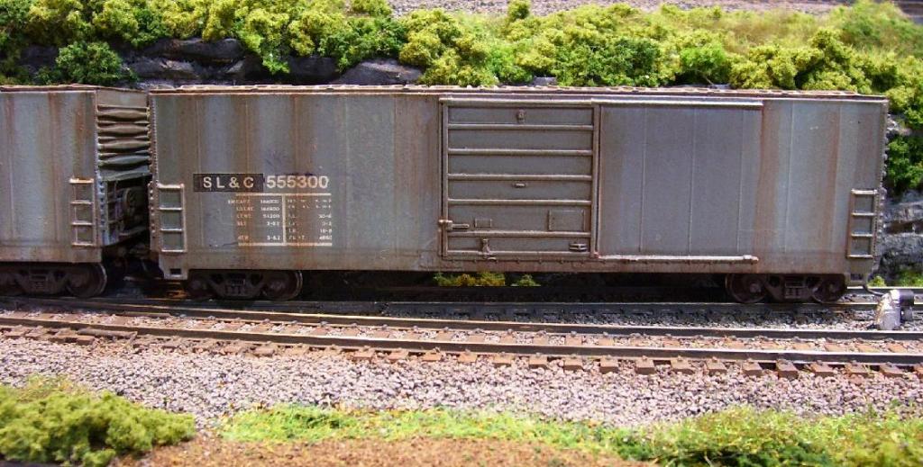

Two weather boxcar I've been working on
SL&C 555300
SL&C 555640
Looking good, MLW. Especially nice job on the patchout and the roof.
