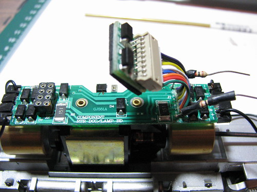

I found a spot on the RTR Lamp board for Funtions 3 and 4 to hook my LED ditch lights. But now since the lights that come with the engine are 1.5v and that won't be enough for the LEDs. What could I use for the common wire (power) for the LEDs? Could I use the + motor pickup, or the + rail pickup?
Your using DCC? don't use the motor or the rail!!!
Find the common for the other lights and see what voltage/ polarity it is.

I am not sure where or how to attach them to the RTR board as it confuses me and usually goes away when I install a decoder.
Yeah i'm using DCC. I havent dropped a decoder in this particular engine yet though. I think the polarity/voltage of the light commons are 1.5v since they use 1.5.v bulbs already. Athearn has a diode installed on thier board to keep the lights at that rating when converted over to dcc.
I lready have 1K ohm Resistors solder to the function pads for the Ditch lights. shown in photo above.
Ok so they might not work at 1.5v with the resistors there too, just wire the ditch lights to the decoder when you put one in, most have 12v outputs, your 1k resistor is ideal.
Ken.
Oh ok thanks.
I'm going to use the D13SRJ decoder,i'm just plugging it in. I dont think there a place on the actual decoder to hook up the common. Could I snip the blue wire on the wiring harness that is connect to the light board and use that.
Not familiar with the decoder, but if it's got the wire harness and all the other lights are run off the athearn board then yeah, that'll work. Cut the function output wires too, unless they go to the athearn board?
