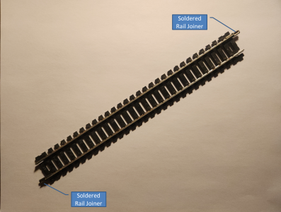

I am beginning a new build using HO track like you described that i bought in the 1980s.
I don't want to solder the entire track nor permanently attach it to my board so i plan to solder one rail joiner to each end of the track similar to American Flyer track.
Before i solder the rail joiner to the track i plan to connect two pieces of track together and pull them apart to see which end of the rail joiner is tighter. I will then solder the looser end of the joiner to the track.
I also plan initially to measure resistance using a DVM from home depot to check for variations in continuity.
