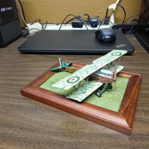

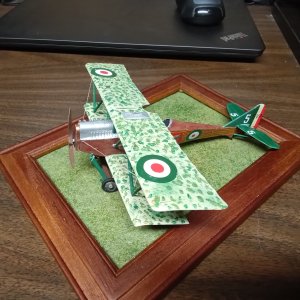

I recently tried this on a model airplane I was working on. Not having correct colors for an Italian WW I biplane and having little inclination to ever build another, I found close enough matches in stash of cheap acrylic paints. One I used the same thinner I use with Vallejo paints. 50/50 mix was to runny so added more paint.The second had sat for so long I just poured off the top and used as is. Results where acceptable for what I was doing but not really super high quality.
Did you apply a flat clear over the paint?
Actually I did. This paint job really used everything but a roller. The green on the tail was the acrylic paint airbrushed along with a red area not visible under the wing. The base color of the wing is from a old discount brand spray can. Engine cowling is also from a spray can. The fuselage is hand painted with Vallejo and the wing camouflage is again the cheap acrylic green hand painted.
