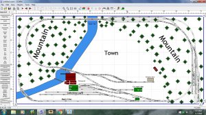

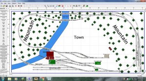

I will try this thread again. No fighting allowed!!! I am sick and have been fighting it (whatever it is) since before Christmas. As i have felt up to it i have been working on a completely different layout plan. only a few things are somewhat the same. The layout is 36"X 6',5". I haven't started it yet. Haven't had any energy for anything. Have work on the truck and haven't done any of it. Work on the house and again, done nothing. Not sure when i may do anything again. Have a couple of shots of the new plan. Still have no name for it. Still not sure if i want steam or diesel yet. Not sure what era. Not sure i will even ever build it. Anyway, there it is for what it is, Dan

If the intent of this plan is realistic operation, your plan is not good at all. Suggest you do some serious reading on how RRs operate & what kind tracks they use to operate. These comments are based on being around real RRs professionally since 1974 & a modeler since 1956.

So in summary I would classify this as a continuous loop with branch. A very versatile plan for a small space. My 2'x8' was this type. I had a mine at the end of the branch.
My first comment would be that the main line should not go through the ladder of the yard. That could easily be fixed by making the yard track closest to the edge be the main instead of the 3rd track. That would also prevent a local train made up in the yard for the branch from having to cross the main. Or connect the main to the lead into the loco house instead off off the yard. A train would still have to cross over the main, but the main wouldn't be slamming through the yard ladder.
If you really don't want the main to be along the edge of the layout (which I agree is pretty boring), then the yard area could be made into some industries. All one really needs to serve the branch is a yard of a single spur. The passing track in the very center could be re-arranged and re-purposed for this.
Or yet another thought. Turn the main in a bit sooner, make the yard 1 track larger, and make the branch track leave from the yard. Eventually curving up and over the main.
But having said all that. A logging railroad is a very different thing than a normal RR especially a class 1. Do you know if you are planning the logging RR to be from the log camp down to the main, or is the logging RR the whole thing?

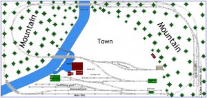

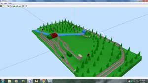

Well, Here are the changes i have made so far. not sure but i may change a couple more but don't know how i can do it yet. shot below, DanScreenHunter_76 Mar. 07 14.17.jpg
I think the basic concept is on the right track (no pun intended!) ... I'd tweak the yard area in the front quite a bit, however... also, for the mostly hidden main line, I'd keep it visible up the left side there and not enter the tunnel until about the upper left hand corner. Do I read correctly that the overall size is 3 feet by a little over 6 feet?

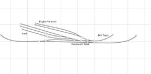

Here's a very rough and incomplete idea for how to begin tweaking the yard -- adding a runaround off the main, and a drill track off the runaround that allows switching the yard and engine terminal (that is an engine terminal, right? if not, disregard) without fouling the main.
Again, this is just a very rough concept, and lots of room for improvement.
For whatever it's worth...
ADDED:
I left the branch off my sketch, but NOT because I think the branch is a bad idea --just for simplicity. I do think the branch line should not come right down the yard ladder, though -- maybe you'd want a runaround up the yard ladder as well, or something like that.

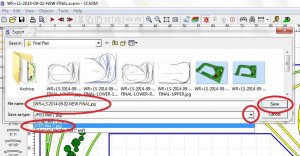

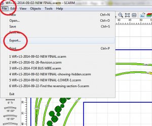

BTW, Dan -- not sure if you were aware that it's possible to save a JPG file from a SCARM document so you don't have to do screen shots each time.
Like this: File | Export
Select "JPG" from the Export options (see dropdown menu arrow at the right); confirm the name of the jpg file (I suggest you save as a new file each time, using numbers, but whatever works for you); then click "save".
Didn't know that. Will try that. One of the problems I do have is that one of my sites has a max size on it and I end up resize it to post it so I just post that size at all forums.

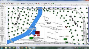

Well, This is what i have right now. Still not happy yet. i need to figure out where to put the company store and i don't like the runaround for the engine on the track to the logging camp. Not sure what i am doing there yet. DanNo Name 1 .jpg
