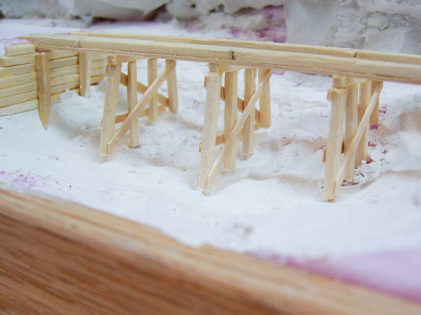

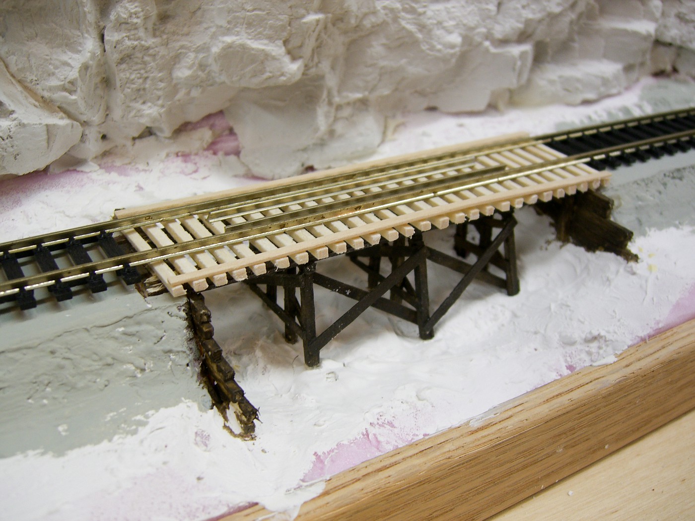

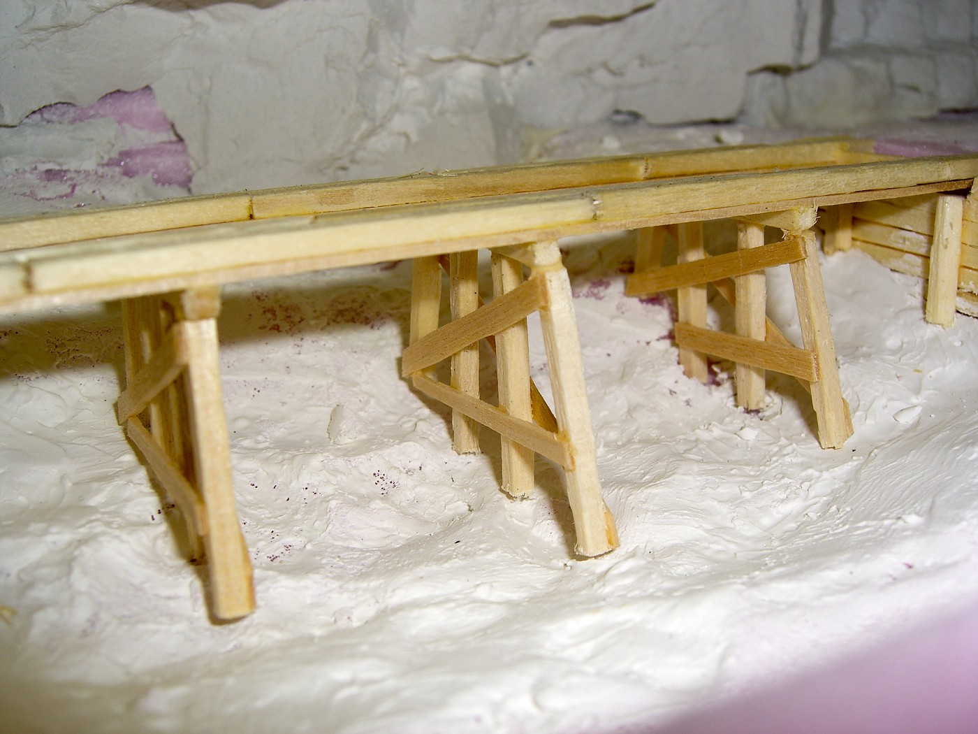

future trestle.
Looks like a good start, Anton. With some sculptamold, you can carve some pretty convincing rocks into the pink foam, especially if you're doing a southwestern theme. The trestle would be a good place for a dry wash, running along the grade, to cross the tracks.

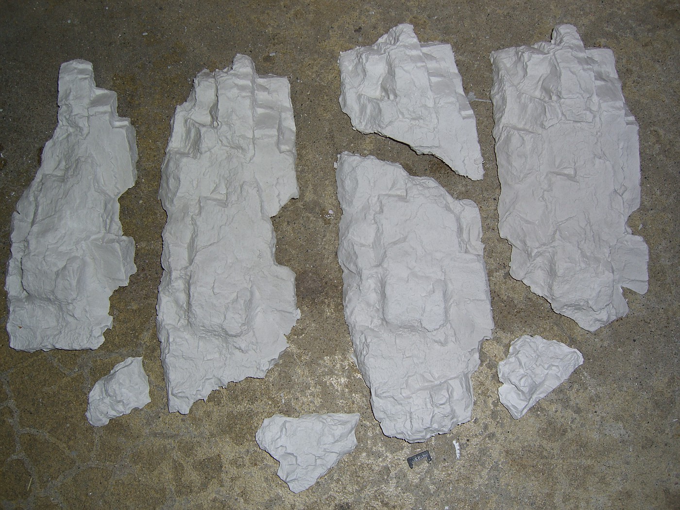

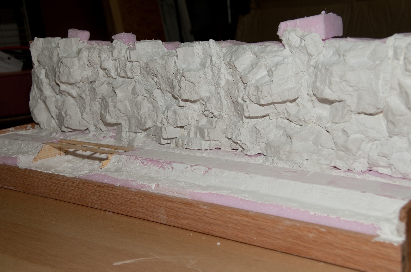

cast a wall and tried my hand at carving. i knew i'm a poor sculptor but after half an hour irealised just ho poor. tonight went with dad to help him move stuff and a hobby loby store happened to be in the way. broke down and got me rock mold.
some cast rocks
this will look much better then my pathetic carvings...
Anton, I use those molds ALOT!!!! Woodland Scenics makes a bevy of them for all different moods. I know you will like them much better than whittling down foam board, and MUCH less messy. They weather/color up nice with washes too.
Bob
glued the cast rock pieces to the wall and filled the gaps. looks awesome to me. infact i think i'm going to revisit the rocks on my main layout.

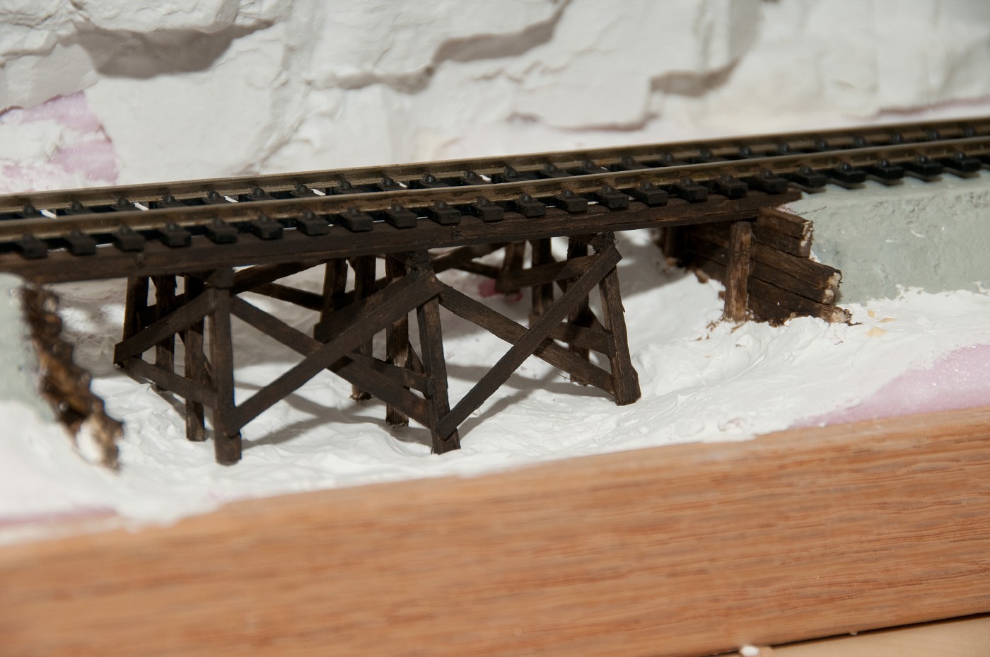

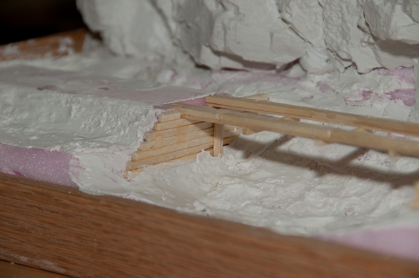

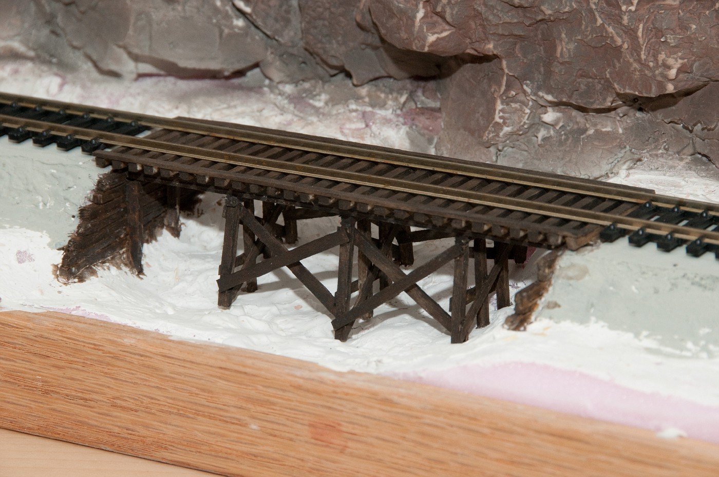

trestle abutment (no vertical supports yet)
Looks good. It's fun to really focus on a couple of square feet. I did mine mostly to experiment with materials and techniques. Definitely got some lessons learned out of it.
Doug

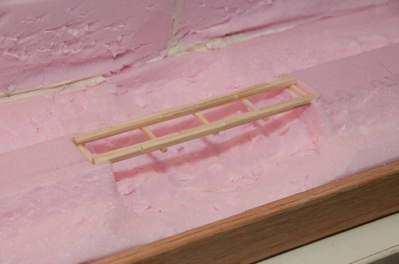

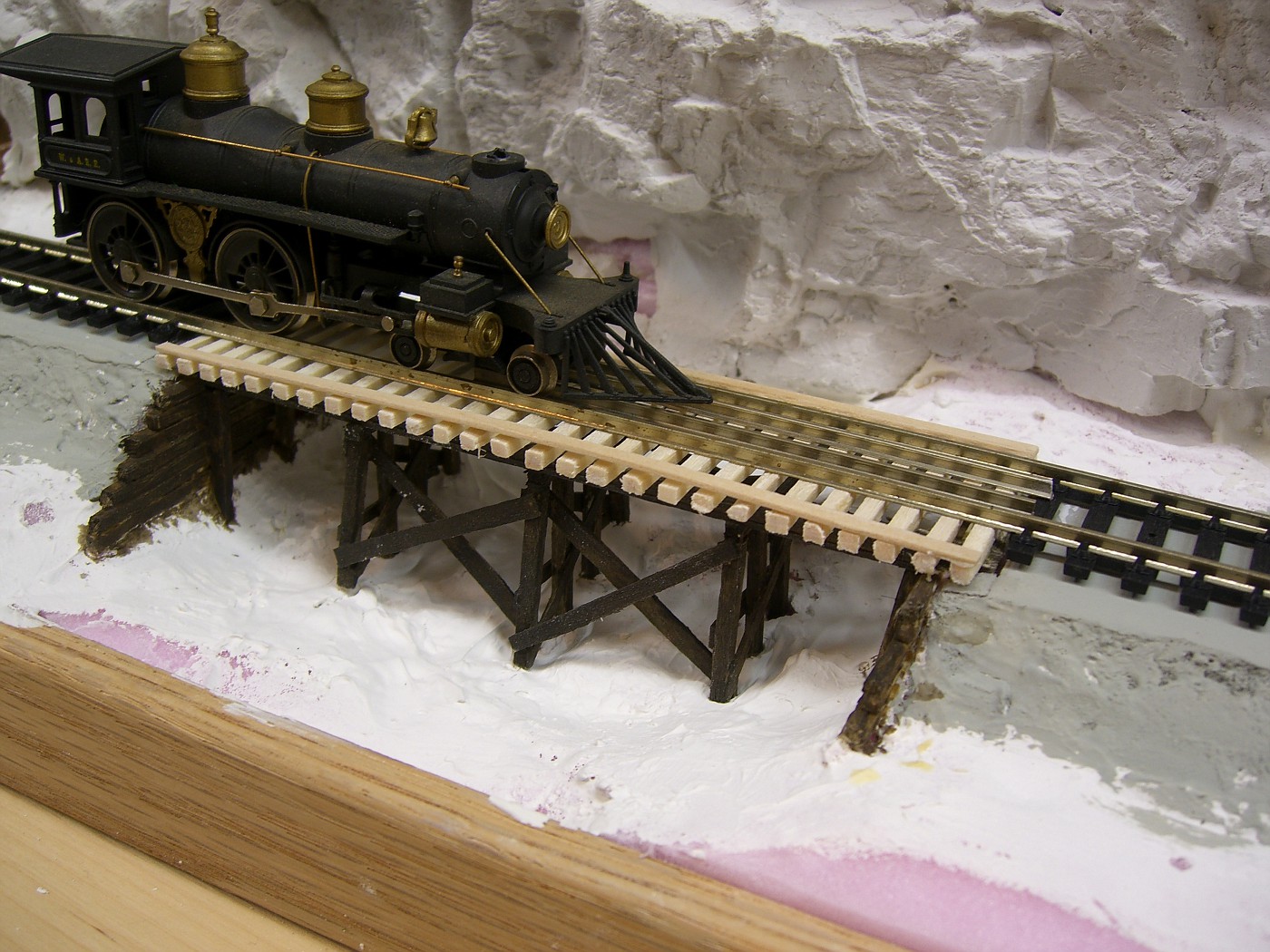

removed the black plastic ties and glued in the wooden ones. will need to figure out what to do for spikes
the boards near the edge not yet glued in.

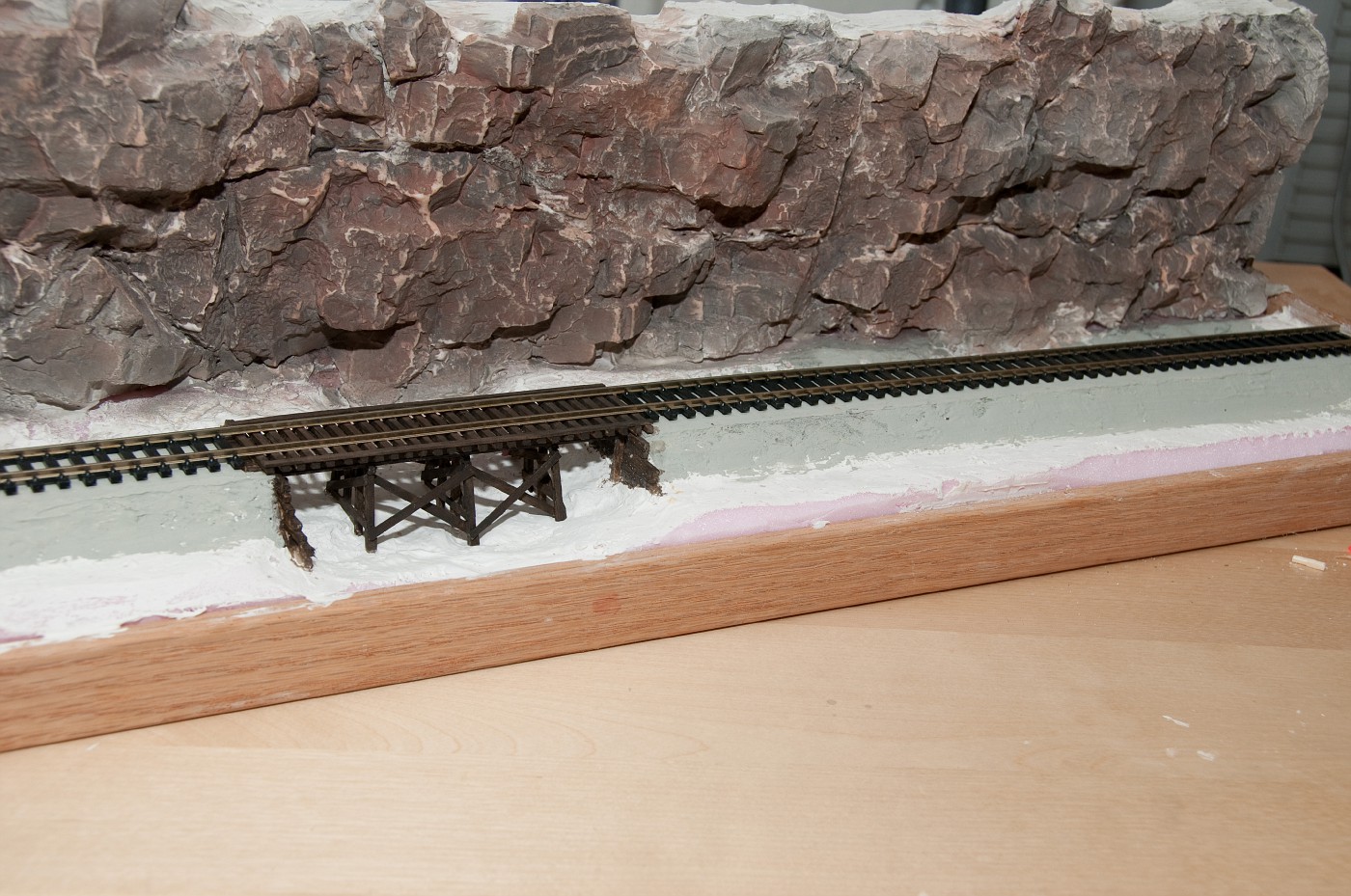

finished and painted the trestle. track is not attached yet.

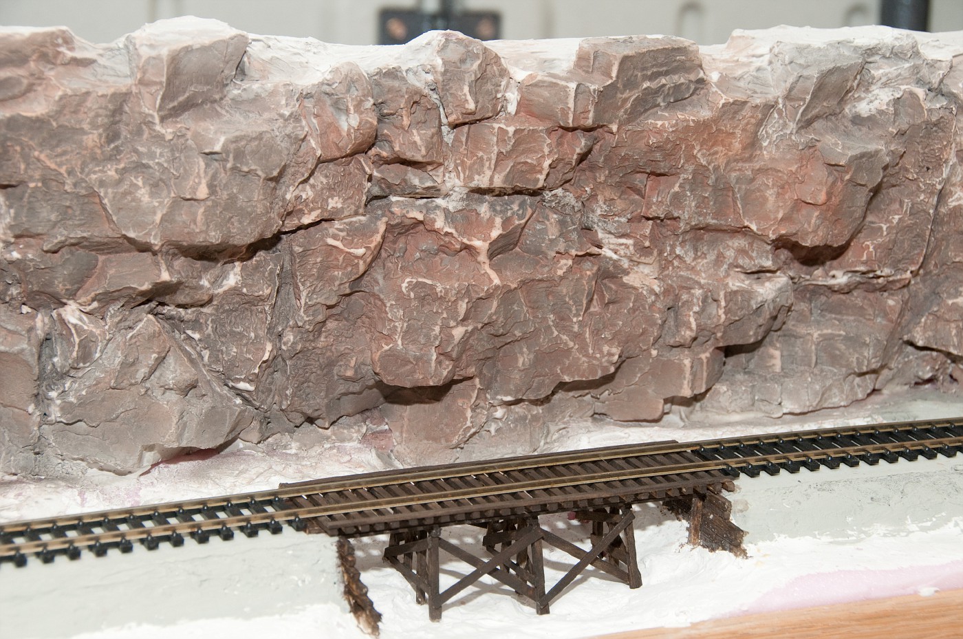

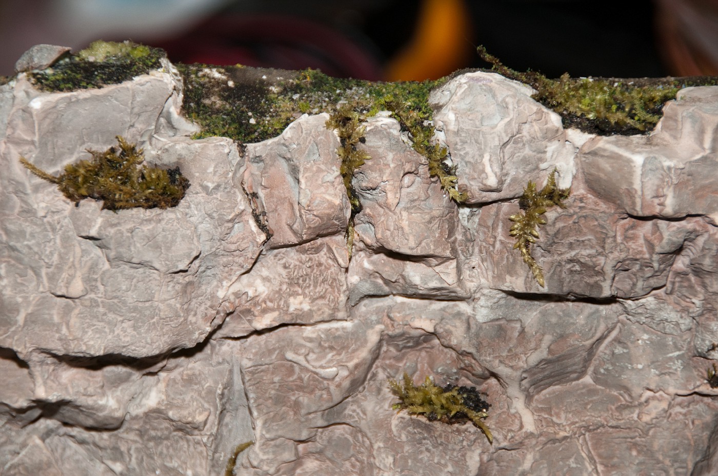

took on painting the cliffs - first try at using an airbrush.
blew a coat of india ink/isopropyl on it. covered mostly everything but somehow it didn't reach the deepest cracks. so i did another run this time working the cracks from very close distance literally drenching and making the ink mix run. mixed burnt sienna acrylic with white pigment and lots of water. tried to brush it and almost had a heart attack - seemed that I was overdoing the color, so i brushed it with just water trying to spread it creating puddles on the clifs (layed it flat on the table).
wife, who is usually VERY critical of my work (she is not of a people who sweet talk things. with her its always between the eyes) suddenly really liked it, which i guess means its not all bad. but still, somehow i'm not 100% satisfied with the results...
something needs to be done. your hard critique and suggestions how to fix/ improve are welcome.
overview
another
painted trestle

Anton, I've found that "sponging" on the base color is much faster and a bit easier for the "base" color. Of course, when using India ink, rubber gloves are a necessity. Nice job, looks good.
I've used the "sponge" technique for years. Daubing on the color and let nature and gravity do its work. Using a soft sponge also allows me to get into the cracks and crevices. I then go back with another sponge and different color textures followed by airbrushing the highlights. I've even used "rattle cans" to spray highlights, mostly using an "overspray" technique. And I've added texture by adding real dirt, glued in place. Amazing what can be done with a simple casting with a bit of imagination. Adding a fine covering of greenery also adds color and texture. Imitates those plants that can grow anywhere. o
I knew a guy that thought the gloves were unnecessary in the application of an India ink mix. His hands looked "dirty" for a month!!!! lol

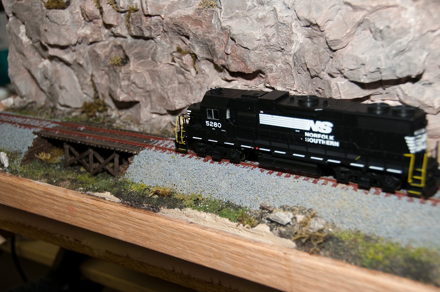

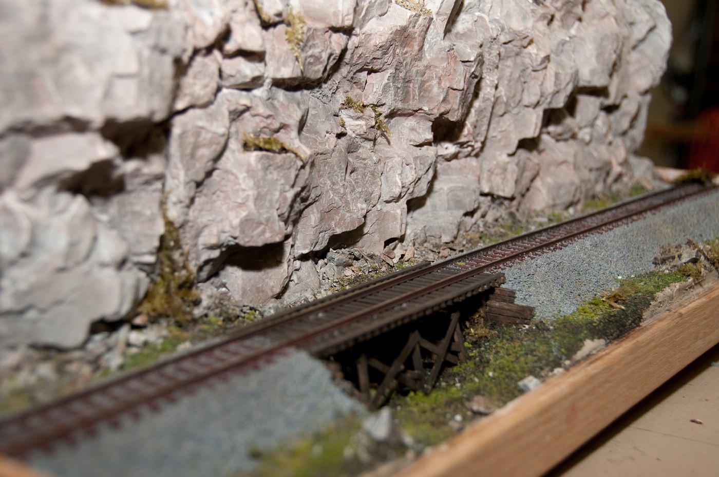

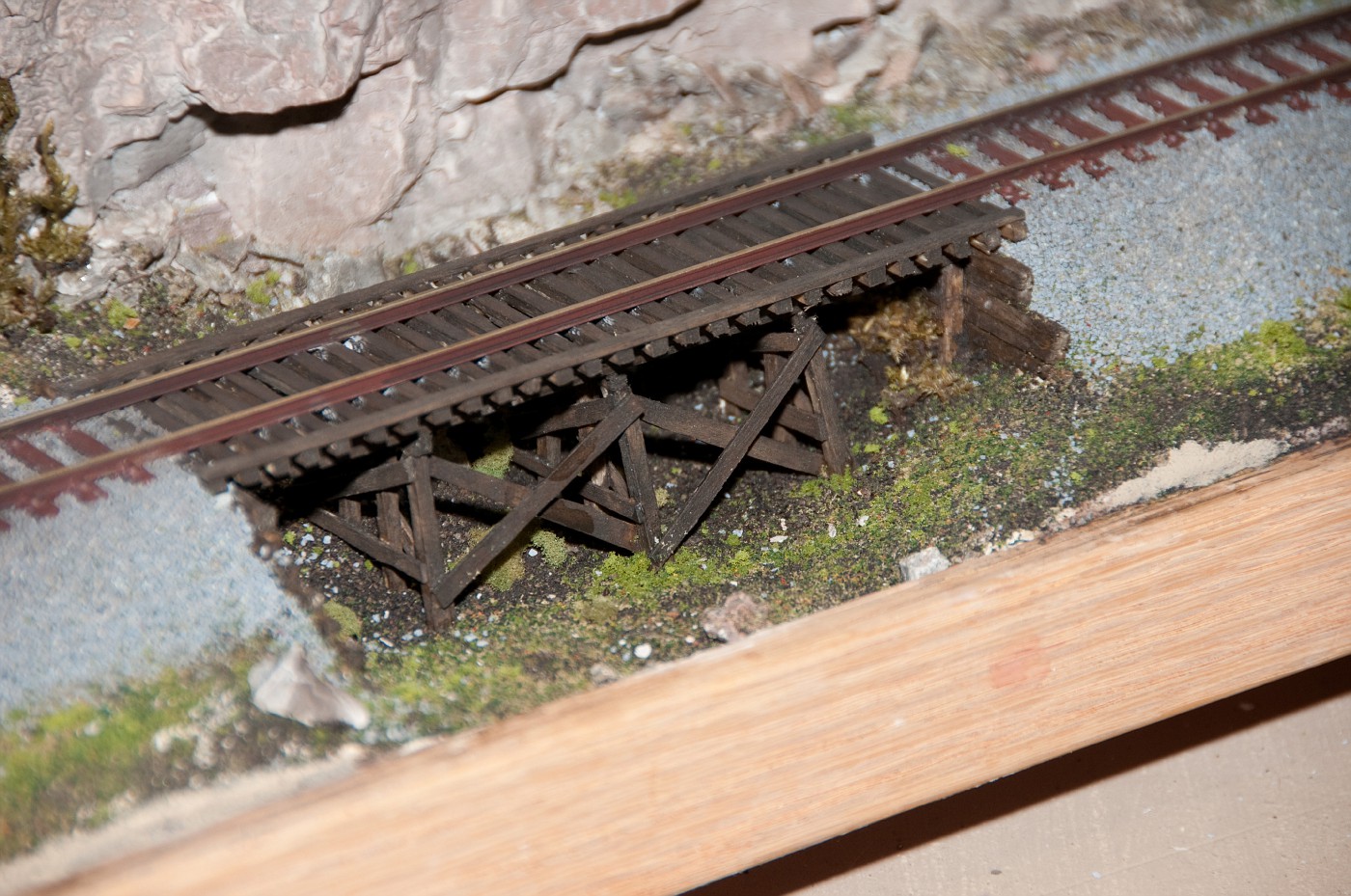

ballasted and did a bit of landscaping work.
after everything dries up i will be touching up on things here and there. and first probably be dimming the flamy/ rusty rails

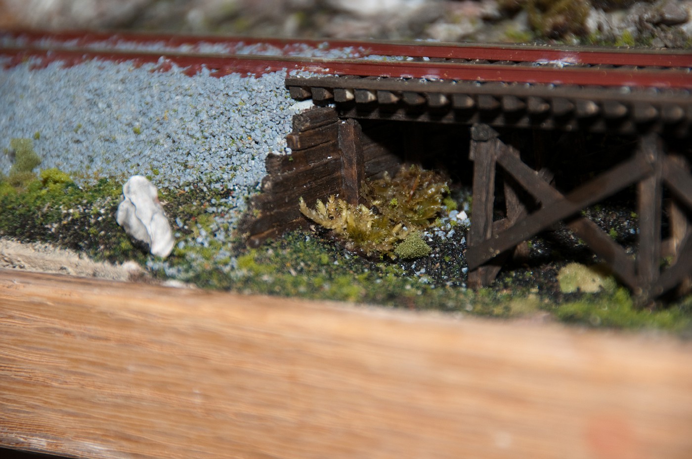

some shrubbery under the trestle
some vegetation on the cliffs

tried to dumb down the reddish rail color. used the same mixture of paint as main layout. will need to touch up couple places with a brush but it is much better, IMHO. still lots of greenery to plant :)
while guard rail is in the works, spikes are dfinetly missing here. me thinks sewing pins should make neat spike heads.
