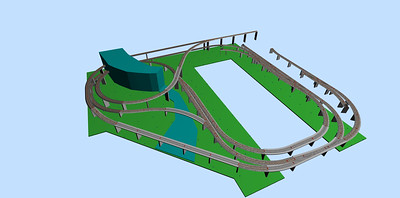

My SCARM abilities are not the best, but here is my current layout:
(Without scenery) :

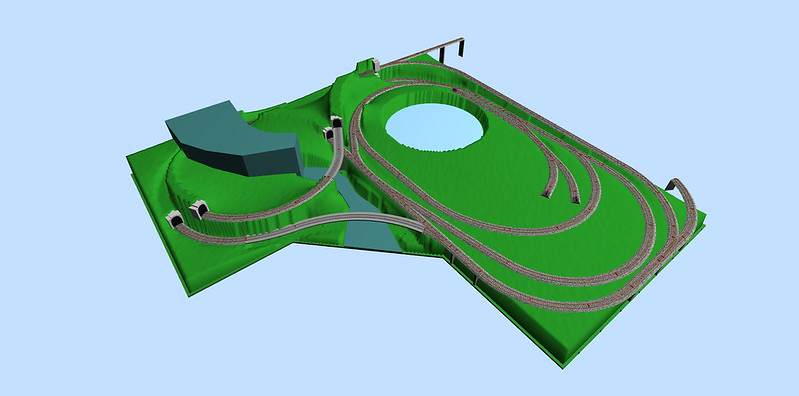

So here's my plan:
Start by cutting the layout right down the center of the 7'6" length and pull the left hand side (as you look at it) away from the wall about 6". The mountain tunnels will also be moved forward about 3-6". This will allow a new track to be laid behind the existing one that will curve at a 22" radius and make it's way around the perimeter. This will be the new main line. A new bridge will be constructed and the river extended.
All the mish-mash in the middle will be axed and an aisle created. The bridges at the front will be either a lift out or duck under to allow easier access to back side.
The section along the right wall will be the industrial center and the track that goes from there down along the back will have a MUCH gentler slope down to the lower tunnel (currently at 4%+).

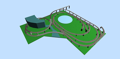

Should look something like this:
(without scenery) :
Thoughts?

I think I'm going for it. New thread coming soon. One question, though: For the bridges in the foreground, would you do lift out, lift up, or duck under?
