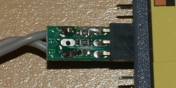

The 'toggle switch adapter PCB is the 3rd attachment, about $2. each plus a $1.50 SPST toggle. I used larger flat handle to more clearly show position (over regular small diameter toggles) since I'm not using LED's (that I originally planned for with Tam Valley).

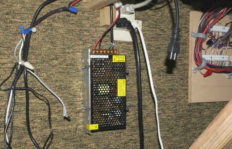

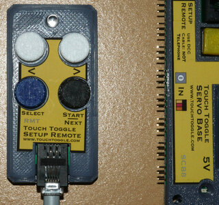

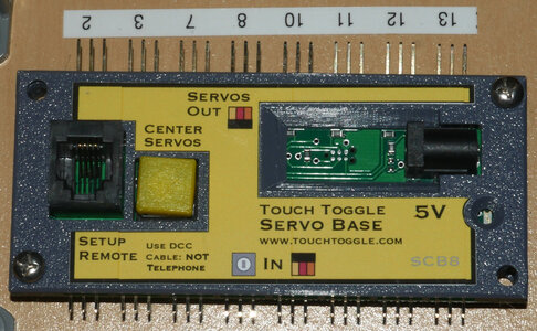

The 'Setup Remote' is used to program the 'Servo Base' (controller) via a RJ45 jack. The 'Servo Base' requires 5vdc thru a 5.5mm coaxial plug (not the ideal method in my book). The idea was to prevent shorting out the PCB due to the wrong polarity (no reverse polarity protection apparently). I purchased a industrial enclosed PS (one that requires a separate grounded power cord) instead of a bunch of 'wall warts'. ;) When (and if) the dust settles I will have eight modules to receive power.
