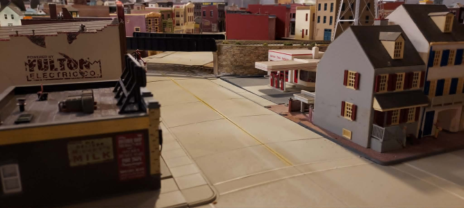

This one part (on the far side of the bridge in the first pic) was originally stuck in a corner. There were mirrors on both walls of the corner, as can be seen in this photo. That was in the attic storage room. The mirror was halfway across an intersection, so the town houses that faced the mirror on one side of the intersection, were duplicated across the street (which also doubled in width in the mirror. )
Then, when the layout moved to a bedroom, that part was no longer back in a corner. But, it was against a wall on one side, so the mirror was installed on the wall as seen here. The town house with the dark red shutters is reflected in the mirror.

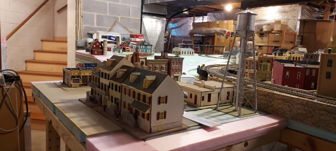

But now, the layout is in the basement and it can just about be walked around completely. This same little section, (that only ever existed to carry on the scenery into a corner) now sits out in the middle and can be walked around on three sides. No more mirrors. But, to make it work, I added a bit of wood framework and narrow strips of foam on top of that on two sides. I glued the foam strips in place yesterday. They will need to be paved over, but the structural work on this section is now complete.
Since its no longer pushed back in the corner, there will be a bit of redevelopment going on as I've changed out most of the structures. But, the row of town houses and the corner drug store building ( with the fire escape) remain. Some of the structures that were originally on this little corner of the layout, have been moved to the village on the new expansion part of the layout.
