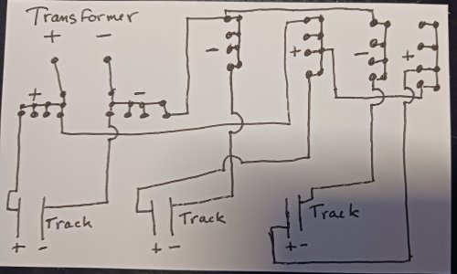

Update: I actually went to my local model railroad supplier, Iron Horse Trains and bought a brand new controller, and I'm sorry to say this one seems even worse than the first one. I have a Fluke 87 meter and I'm a "know the path by testing continuity through switches" guy and I just can't see how the turntable motor gets a common to run from the X-Y. It can't be coming from the incoming power from the power pack, so it must be coming from the C terminal beside the X-Y, but the schematic doesn't actually show that I can see where the C makes contact with either the X or the Y to provide the complete voltage to turn the motor. At some point I am going to drill out the rivets and look at the internals so I can see exactly how this works. But for now I'm content with using the Twin method to turn the motor on and off and reverse the direction. It could also be the way I have my layout wired. I have the "plus" and "minus" wires from my MRC model 500 transformer each going to it's own 12 position terminal strip with one of those connectors on the top that make each terminal the same no matter which terminal of the 12 I use. I posted a pic of my wiring, only 4 connectors where there are actually 12.
I have several of these at locations around my track so I can get a complete circuit to track power from anywhere because all my terminal strips are connected in parallel with the main transformer power. Each connection to track power from any of the terminal strips can then be interrupted by a switch to control the power to that section of track.
This might be why the controller does not work for me, because I'm not letting the controller control the track polarity for reversing polarity on the rails because of the way I have the controller connected to my power.
I think you just answered your own question. The Atlas Controller is meant to be your reversing switch, not your transformer. But there's more to it than that. Based on your current wiring diagram you just supplied, here should be the solution......................
In addition to your Controller, you will also need an Atlas Selector. Then looking at the Atlas wiring diagram, hook your power pack up to the Controller. Hook your turntable motor up to the X-Y terminals. Now, for the turntable track, hook the "C" terminal up to the "C" terminal on the Controller. Hook the No. "1" terminal up to the No. "1" Selector terminal. This will be your block "1". Finally, unhook your main track power leads from your transformer. Hook one lead up to the "C" terminal on the Controller. Hook the other wire lead up to the No. "2" terminal on the Selector. This will become block No. 2. Just set your reversing switch on the power pack to one side or the other, doesn't matter, then don't touch it again. Use the reversing switch on the Controller for direction control. After doing all this, it should fix your current problem, and lead to limitations.
If I'm reading your current wiring diagram correctly, you only have one big block, electrically speaking of course. What you will find is, adding a second power pack "B" would be pointless, because only one power pack at a time can be used to control your entire layout. All you would be really doing is switching from one power pack to the other in order to run the entire layout. Like I say, what's the point?
If you are content on your current method of running your turntable motor with an Atlas Twin, I'd just do that and forget the Controller. Now I'd be willing to bet that your Atlas Controllers are just fine, it's the way you have your layout wired that's not allowing the Controllers to work the way they are intended to work. You would either need to rewire your layout to conform exactly as shown in the Atlas wiring diagram, or else forget the Controller and Selector methods altogether.
