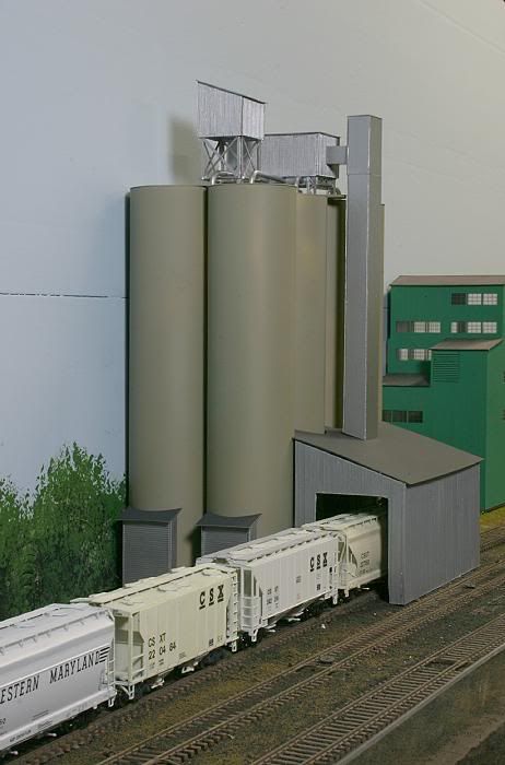

I originally bought the Walthers Valley Cement complex, but discovered that my layout simply didn't have the space for it - so I just scratchbuilt my own 'Medusa-wannabee' structure using PVC pipes:
http://i39.photobucket.com/albums/e182/CSX_road_slug/misc_etc/cement_silos_rough_draft.jpg
http://i39.photobucket.com/albums/e182/CSX_road_slug/lineside_industries/SummitCement04.jpg
http://i39.photobucket.com/albums/e182/CSX_road_slug/lineside_industries/SummitCement02.jpg
These facilities can be located anywhere as long as they are equipped with so-called 'bag houses', which are like giant vacuum cleaners, to collect stray dust. The baghouse on mine supposedly exists behind the silos...:rolleyes:
