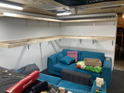

Hello everyone
As i told you in my "hi" thread, i will now start to show off my H0 Scale project with no name yet. i will show you my progress and i try to share my learnings i got. i started with N scale stuff, and did some dioramas in N and Z Scale (The Z scale is in Showoff). After those dioramas i knew i love to build scenery and detail stuff. But not in this small scales. So i decided to start a layout (project B) in H0 scale.
What i also knew is that i love the style of american modelrailroad layouts and also northamerican trains. so thats why project B will be US themed and shelflayout point to point. I started building on the easter weekend. first i built the base. everything is 60cm deep and both sides are around 2m20cm long, so i have a bit of space to build some industries a mountain in the corner and so on.
Here are some pictures from the first day of building.

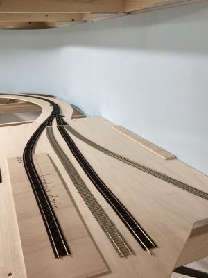

After i built the framework, i started to lay down track, i will work with Peco Code83 and electrofrog turnouts. I will build everything DCC, my digital Station is the Z21. I will not work with a trackplan, it will all be laying down track, check if it looks good and then go on. after several try's i came up with the following idea for Section D.
From left to right:
Loading Dock Track 1
Loading Dock Track 2 (Side)
Mainline (that runs trough the industry district further down east (will end here till i maybe add a swing bridge)
Industry Track 1
In the back you see a curved turnout. it turns out that this way it looks way smoother. the curve in the back will be tight, but i will do testruns to see if my 6axles can smoothly pass trough. the whole curve will be covered in a tunnel, for A to block the vision on section C and to B cover the tight curve ;)

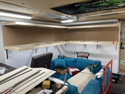

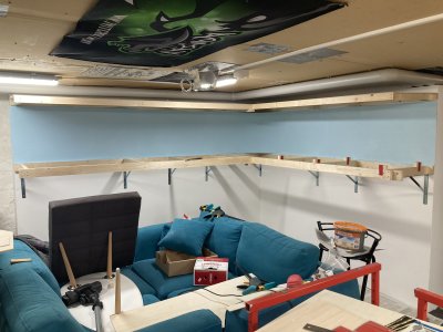

My next update is here. after installing all the benchwork and also the top, it was time for the backdrop. So i added some 6mm sheets in the back. then painted it white (2 times). after that i mixed a light blue color and painted it also 2 times (this picture is after the first layer).
So this means, i will add the second layer today and then its go time.
View attachment 185660View attachment 185661View attachment 185662View attachment 185663
From left to right:
Industry Track 1

Looks great so far. What will the curve radius be behind the mountain? Will you be able to access that area if needed?
i can not really say what radius it will be. the space there is around 80cm deep. i will cut out the track so it will be accessible from under the benchwork. the tunnel will only be around 40-60cm long i think. really just to hide the big part of the curve and as scenery block from section D to section C
It sounds like you have a solid plan for future access. As we've all found out, that is very important.

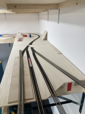

Hi community
iam back with a question for all of you, or some inputs.
here you see two ideas on how i build up my shelflayout and iam still wondering which way to go.
V1: wood as underground frame, with foam on top. on top of that roadbed and then track. the good things about this, easy to build scenery on it. also to easy carve out holes or other landscaping stuff. negative (in my eyes) i will work with tortoise switchers from the underside, so i have to drill a whole trough everything.
V2: the wood is only used for trackbed. all the stuff on the side like buildings streets and stuff will be on foam. good thing? the switchers can be mounted directly on the wood and i dont have to drill trough everything. "minus" i have to adjust the heigt so i get a flat surface.
so here is my question, which way would you go and why?
Thank you for your feedback.
Cheers
jaY

Most people use foam, I do not. Totally a personal preference. My wood is the low point and if I want elevation I cut it out of a bendy wood material like 1/4" luann or plywood, mounted on graduated wood blocks to get the grades smooth.
Foam is messy and there is no reason to carve it out if you plan your layout and make the plywood the lowest grade. I used something called hydrocal for all my landscaping/base/terrain. It sets up fast and solid. The learning curve may be a bit tougher, but once you get the knack it is a piece of cake.
Roadbed is a good idea, however I did not use any of that either. There are hundreds of ways to build and, if the train runs well, that is the right way in my book.
Some modelers put down foam no matter what and I am not sure why since it does not hold nails well if at all. You can stick a tree in it.
That is my opinion and it may be a minority opinion. You can see my layout building by clicking on the my youtube channel in blue at the bottom of my signature. There are two separate layouts on my channel. The latest videos are my new layout.
Hope this helps, Dave
thank you both for your answer. i think i will go with a kind of mix. in my industrie part (Section D) i will go all ply, then its evan andd i can work with a solid base. when iam out in the open (section C) i will do a mix, because in the front of the track i will try to model the end of a lake. thank you for your inputs.
and i will check your youtube channel @logandsawman .
IMHO, both techniques have their place and I've used both. If I were doing mountain scenery the track would likely be on wood (cookie cutter) with hardshell to form the terrain. Look forward to seeing what you come up with.

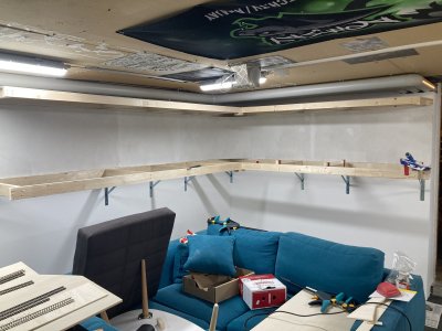

yesterday evening i had some time to go down in my basement and work on the layout. i glued and screwed down the first wood and also did work on the idea for the curve.
Well after several tries and thnx to the delivery of my first "bigger" box car i found out this will not work how i was thinking it will. back to the drawing board i guess. the curve has to be bigger, so my industry on section D lower left in the picture will be smaller. well it will be still big but not that many tracks that i was hoping for, but still i think i will manage to get in 3-4 tracks. so i can do a little switching. the curve is now wider so maybe i will not build a tunnel just a canyon esk type of scenery we will have to see if it works. i still love the idea of having a tunnel.

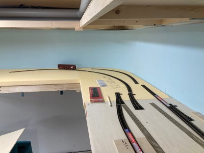

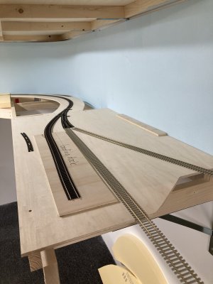

Hey folks.

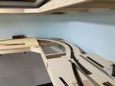

Another weekend is gone and i was downstairs building. Well i was figuring out how to get a decent curve and still some tracks to switch on. After a break where i did try to solder some turnouts and two flex tracks (i hate soldering and it does not really work), i had a idea for my turnouts.
why not flip over the turnout and take it into the curve? and wow that was eye opening. i had more space and now i can manage to get in two turnouts and get back to my 4 tracks i was planing in the first place. and also i got more space so the tracks will be longer for the two industries. hell yeah! i was happy!
But the soldering story is a different one. i really dont get how people can manage to solder tracks. its horrible and i did try it for some time but iam not really happy with it. so my Question for you out there, is there another way to connect flextracks in curves? flextrack connections in curves are hard, or do i have to cut them every time in different lengths? maybe you have some ideas and can help me with :)
btw. i will wait with fixing down the track, till my centerbeam cars arrive, i think those are even longer, so i have to check if they go smoothly trough the curve...
wish you all a good start of the week. cheers jay
Yup, you can plan all you want but things always change as you go!
Nice solution using the curved turnout! You end up with a slight S curve but it doesn’t look too pronounced.
Oh, and yes that’s a big boxcar!
yeah i know that about the slight S curve, but i think its okay, it does not look that bad :D
When i first opened the box car and saw something like this the first time i was. WOW what the hell ahahaha.
I put a mini figure right next to it and was thinking damn that thing is huuuge. but i like it :)
but iam now a little concerned about the centerbeam cars :D

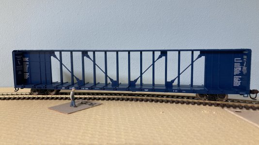

yesterday was the day of truth (is this correct?)
My centerbeam car from walthers arrived. So i got the package, straight up opening and see what i got.
- curved turnout PECO code 83
- Centerbeam Car
- some styro thing plastic plates to try scratchbuild stuff
Well lets go downstairs and check out if this huuuuge car is working with my curve. and HELL it works! that means, Bob the engineer has first to approve the car, then do some testruns and after that go on with the build!
The car looks by the way awesome, some more are coming but it takes about three weeks. this blue one was on stock at my local shop thats why i got this one early.
so that means, i now have to solder all turnouts and then cutting track and see how it fits, then roadbed down and lets go!
