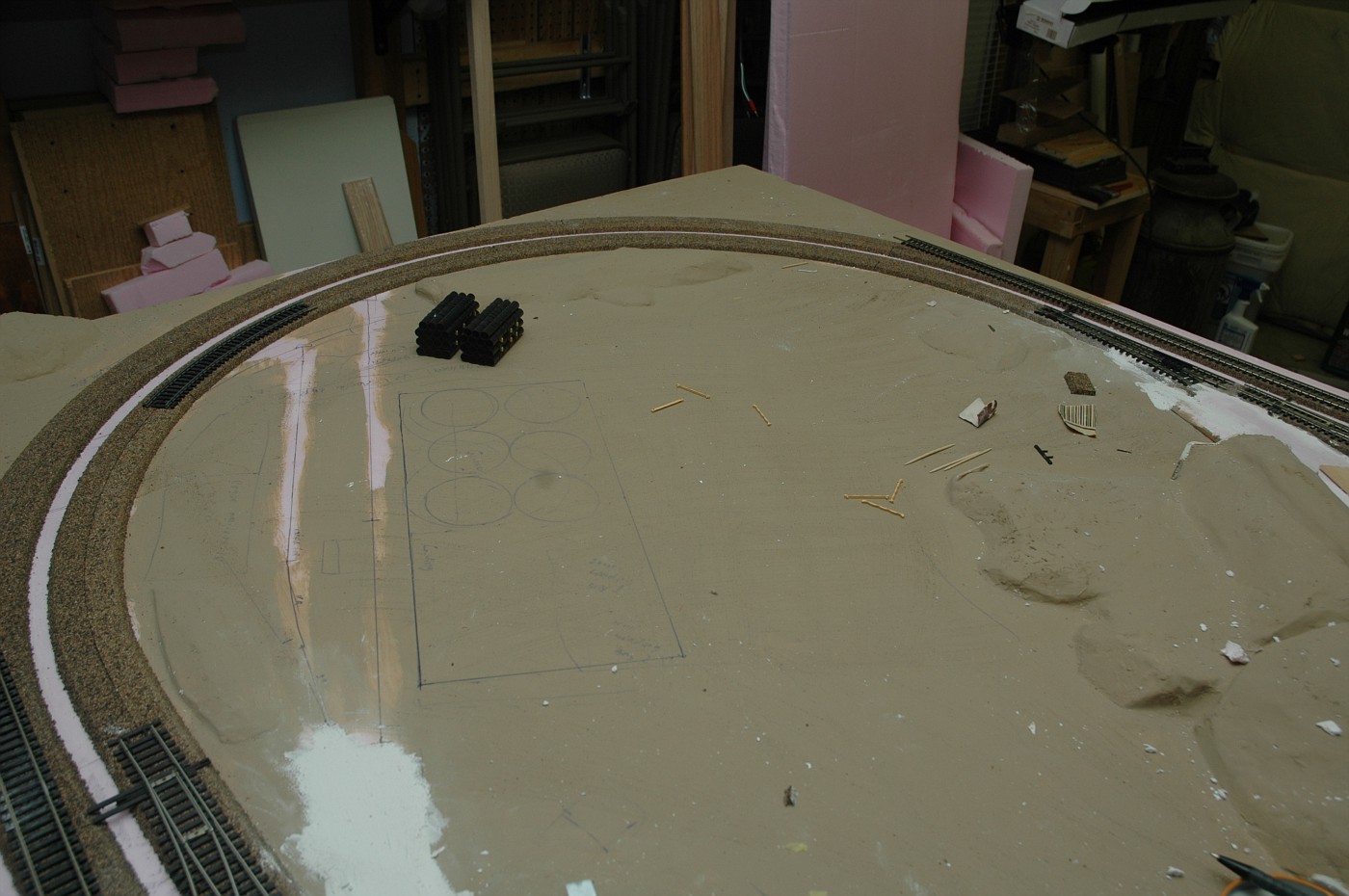

I think its coming along very nicely. Makes me wanna start on my layout so bad but cant, might just have to do a lil 18" x 48" shelf scene just to do some sorta work.
as far as the colors on your hills, are they gonna be dirt, with some vegitation or the evemtually gonna have grass, trees, ect??
i'd say definetly go for it. i'd desing the 18*48 as part of your layout so later to just drop it in
for hills and plain ground thinking to do cover with actual dirt, and some WS products (already got couple different colors and mixes), some places will be grassy, bushes and trees will also be here and there. couple rock faces will be "protruding" from the brown. i think i'll be ok with that.

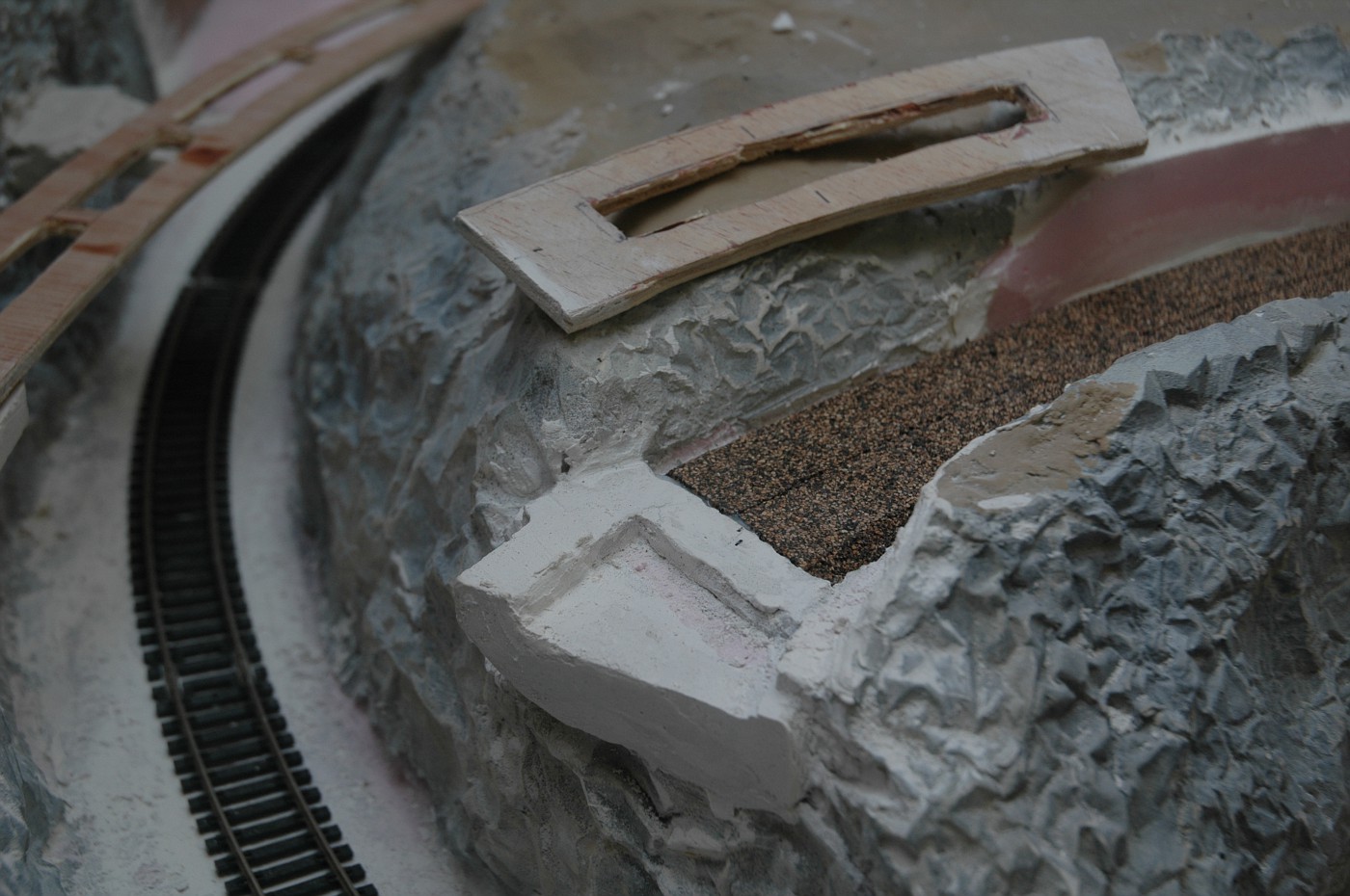

cast rocks on the last missing wall.
cast "concrete" overhanging supports for the bridges. drilled holes in the "rock" foundation and used hanger wire to serve as armature for the supports.shaped plywood strip is resting on those supports and has a cast "bracket" (for the lack of better word) around it to keep it in place laterally and serve as transition from cork roadbed to the plywood bridge.
i will still need to figure out and build another support somewhere in the middle of the longer climb bridge, it holds its own weight but since it is curved the center of gravity will be shifting sideways when train passes and it will capsize.

Bridges. notes welcome
roadbed is flush with the plaster and recessed plywood forming level transition.
climb. the middle support is visible here. drilled holes in the "rocky" wall, inserted a contraption build from hanger wire and "poured" plaster of paris. still need to give it proper shape
climb bridge upper support
descent bridge lower support
upper
note. coloring is obviously not final and will be revisited
