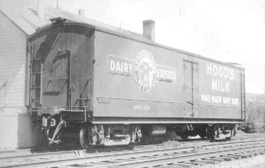

What freight cars might be found in a 1942 passenger train?
Very rare before WWII as they just used baggage cars, but:
express milk
express box
express reefer
Box and reefer would most likely painted for the railway express agency.
They would usually have special high speed trucks such as Allied Full Cushion, Barber S2, or GSC BX Trucks.
They became more common after WWII and REA even built their own special box cars in ummm 1955?.

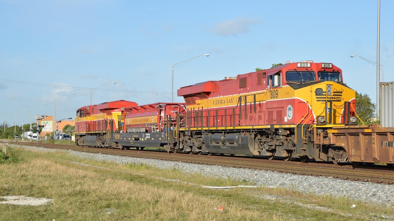

Yesterday we were driving up Rt1 just north of St Augustine, Fl and spotted a fairly long FEC freight train headed south, At thetail end of the train were two passenger cars, one FEC and the other a private one.
All of these FEC trains that come thru now are running with a nature gas supplycar between the 2 locomotives

Something I hadn't considered with locos using Natural gas for fuel. Do they have spark plugged ignition systems instead of diesel's compression ignition (no spark plugs or only glow plug igniters) system?

Florida East Coast Railway converts locomotive fleet to LNG
FLORIDA East Coast Railway (FECR) has become the first North American railway to adopt liquefied natural gas (LNG) for its entire line-haul locomotive fleet.
https://www.railjournal.com/regions...oast-railway-converts-locomotive-fleet-to-lng
On November 9 FECR officially unveiled its modified fleet of 24 GE ES44AC locomotives, which operate in pairs with a purpose-built fuel tender supplied by Chart Industries, United States.
FECR is also the first railway to haul LNG as a commodity under a Federal Railroad Administration (FRA) waiver.
LNG has been tested as a locomotive fuel for 25 years in North America and is still under evaluation by several Class 1 railways including BNSF. The fuel has been adopted by FECR as an alternative to diesel for two reasons. Firstly, FECR’s line-haul locomotive fleet is captive, operating solely on the Jacksonville – Miami main line. Secondly, FECR has access to a ready source of LNG through Florida East Coast Industries’ LNG plant at Titusville.
The EPA Tier 3-compliant locomotives look identical to standard ES44ACs, but their GEVO prime-movers have been retrofitted by GE with its NextFuel low-pressure technology. According to the manufacturer, NextFuel gives railways the flexibility to run on both diesel fuel and LNG with up to 80% gas substitution or 100% diesel.
The gas substitution method retains diesel for compression ignition purposes. A 100% LNG engine would require a spark ignition, like a petrol engine.
The fuel tender was specially-developed by Chart Industries and consists of a cryogenic tank permanently mounted on a wagon, with the vehicle weighing in 67.9 tonnes when fully loaded.
The tender is designed to withstand a side impact from a lorry without damage and the vehicle is fully enclosed beneath the frame to eliminate the risk of a projectile piercing the tank from beneath in the event of a derailment. The design was extensively computer-modelled to simulate worse-case side impact and derailment scenarios.
The cryogenic tank comprises an inner stainless-steel tank within an outer carbon-steel tank, separated by a layer of thermal insulation, the tank is secured to the wagon and protected by a massive steel frame with collision posts.
A gasification system takes the LNG and transforms it into a gas for the fuel injection system. Safety features include valves that snap shut automatically if the LNG plumbing is damaged, preventing leakage.
Refilling an empty tender takes around 90 minutes and provides enough fuel for up to 1450km of heavy-haul service operating at a maximum speed of 97km/h. This is sufficient for an 1100km round trip between Jacksonville and Miami, including idling time and potential delays.
