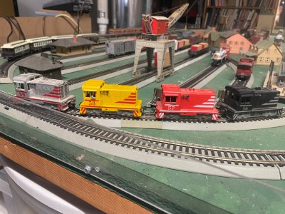

On my small (4x8 with L-shaped yard extension) layout, I do this:
- yard engine makes up outbound train
- industry-based engines gather up INbound train
- yard engine moves out of the way, road engine takes train out for a few loops
- at the same time, a "transfer job" brings the inbound (empties) out to be picked up...
... as the mainline train backs off the "loads" on my "branch line"
- once that's done, the road engine cuts off to find the inbound train...
... as the industry engines spot the cars for the customers
- the inbound train does a loop or two, comes back to the yard
- the road engine runs around and grabs the caboose, moves out of the way
- the yard engine puts the inbound train away.
... all this in about 15-20 minutes of running.
I like to do "a morning job" just before lunch and "an evening job" about 9.15p.
What good is a model railroad if you don't run it?
