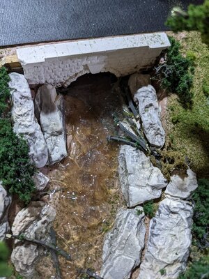

I tried my hand at adding water to the stream.
I came across a guy in the UK who uses Clear-Fix hybrid polymer to model water effects. His results were great, so I set out to mimic what he did.
This stuff comes in a tube for use with a caulking gun. It is soluble in isopropyl alcohol. I used the suggested 99.9% available online.
I wanted to get the illusion of depth, so the first pour was really thin so it would self level and form pools.
I added I couple drops of raw umber and one drop of yellow ochre, then mixed with alcohol using a popsicle stick until I had the consistency of thick honey.
The dye ended up being suspended participates, and sort of settled into the murky depths.
This is the first pour. I let it set overnight.
Then I mixed up a thicker batch without any dye. I still thinned it out, but not so much that it self leveled. Then as it set, I would pat it with a popsicle stick soaked on alcohol so it wouldn't stick too much as I manipulated the water into currents and waves.
I think it came out great! Maybe a little too clear.
