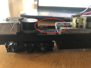

I just pulled out my Tyco Silver Streak train from back in 1980 (I think). I am writing today to get some support. My back up locomotive is not running, but it is very close. I just need some help. it is a Milwaukee Road (see pictures). When I put it in the tracks it will light up and everything spins, but it is not connected to the main engine. And, I am not sure how it connects to the wheels. Please see the pictures below, if you can offer any advice, that would be wonderful.

When you say “everything spins”. I assume you mean the motor and the shaft from the motor, but not the wheels on the truck. The second picture clearly shows the end of the motor shaft disconnected from the input shaft on the truck. The two gray pieces join together to form the connection between the motor and the truck. Usually the just snap into place.

Based off of the pictures, I would say that you are missing a piece. There should be a dog-bone style drive shaft that would fit into the grey cups.
Something like this:
Also looks like you have the motor sitting a little too far forward in the pics.
I'm afraid I'd have to agree with GeeTee. The motor appears to be loose, as well as the drive shaft connector being missing. You might be able to find an Athearn driveshaft part that would fit (possibly from Walthers or on ebay), but it might not be worth the effort. The motor runs on DC only, and if the rest of the set has a DC power pack, you'd want an Athearn Blue Box model. A used one, in working order, would probably be a lot cheaper than a new one. The shell might fit an Athearn Blue Box chassis, but you would probably be better to remove the gears from your model's trucks and use it as a dummy. Let us know what you decide.
That is exactly what I need! I have figured out how to remount the engine and there is definitely distance between the two gears. Thank you for the post! Where would I get something like this? I figured if I can't, I can print it on a 3D printer at school, but no access to it until after COVID.
Thank you, KB02, that looks perfect. Geez, I wonder if I should just buy a new locomotive. They have online for about $55. These repair parts will cost me almost $20 with shipping.
