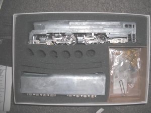

You happend to have there web address? Heres the pics of the train so far..72297[/ATTACH]"]

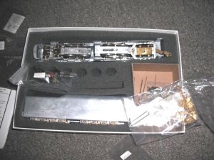

72299[/ATTACH]"]

Looks like that second motor and gear train is that plastic bag. I would attend to that first and make sure the engine actually runs before I went any further.
