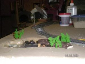

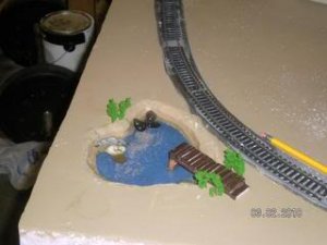

My river narrows and ends over a waterfall. Tonight I only poured the lower fall area below the dam. After a day or so to allow the area to harden I'll pour the main river and post an update with some pics.
The real name for what I am calling Wally Water is Le Silk Shoppe Acrylic Water. Again, thanks to mburns for discovering this great stuff.

yall are welcome glad I could finally contribute something for a change since I have taken so many good ideas and advise for here.74169[/ATTACH]"]
, 74171[/ATTACH]"]
