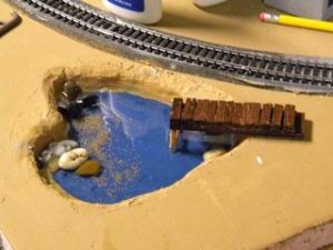

I was at walmart today found an epoxy water used for floral figured I would give it try on my lake. The cost was 5.96 so figured why not give it a try.74161[/ATTACH]"]

Picture is a little small but what shows looks pretty good. Is it fairly thin and runny mixture or does it have some viscosity to it? Please give us a bit of a run down on what you discovered. It looks like something a lot of us might use. I'm presently working on a river bed. Hope to blend in the banks and paint the bed this week and then I'm ready for the water finish over coat. I have Envirotex for the job but might give the Wally Water a shot.

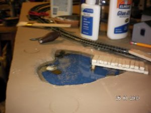

few updates it is almost fully cured.74165[/ATTACH]"]

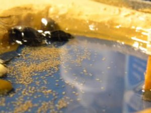

some of leaked out from under the foam board , I should have dug out foam and not cut all the way through to the plywood like a bowl i guess then it wouldn't have leaked.
Looks like it ends up nice and clear based on the reflections of the bottles behind the scene.
A small bead of white glue or clear caulking around the bottom edge of the hole is generally enough to prevent a leak. Not like caulking around a bath tub or sink, just a tiny bead to make a seal.
