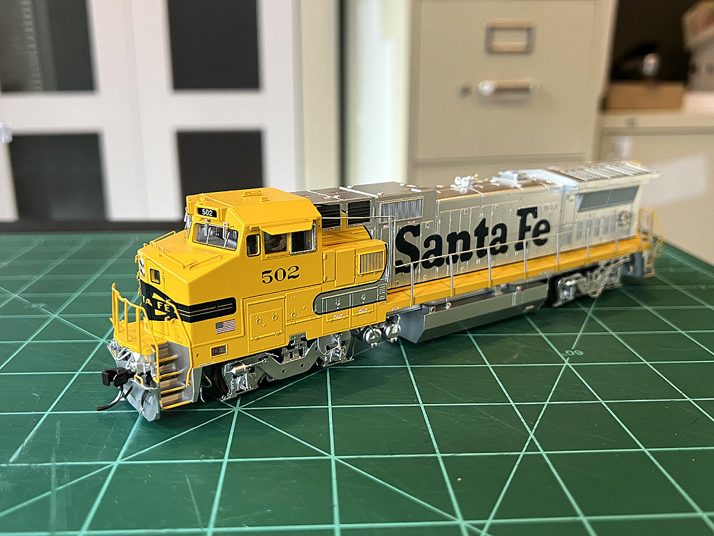

I'm almost certain this is a fantasy scheme, but it looks nice
That is an understatement, that is a fantastic looking locomotive!
couldn't pass it up
No wonder.
when the layout gets built someday.
You’re not alone; we’ll both make it there eventually. For now, I’m enjoying piecing everything together, and it seems like you are too.
Congrats on such an amazing discovery.
